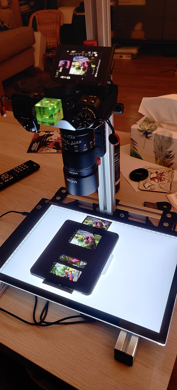

I've still got my scanners, but I'm going to try to move to DSLR scanning for speed, even if it's slightly lower quality. I've got a Pixl-latr and light box ready to go but had been looking for a copy stand and saw that it's a recurring theme. I found the kit below on a web trawl at the weekend and have ordered it - it ended up about £45 delivered, but it's coming from Germany, so I likely won't get to show any results before the end of the month:
It's really simple and looks sturdy: the 30mm aluminium extrusion is used in 3d printers and we use a lot of it in the lab for various purposed. As constructed, I'm pretty confident it will be really stable (they use a sensible assortment of the fittings available for this type of rail). I had a quick attempt to spec up the required hardware from UK suppliers, but the faff involved wasn't worth it (you could match the price if you really try, but you'll have extra components left over and will need to spend time cutting longer stock to size and finishing the cuts)
You do need way to mount the camera - I've ordered a cheap acro-swiss holder from Amazon, and I'll use a macro rail to make it easier to get the magnification and focus sorted.
