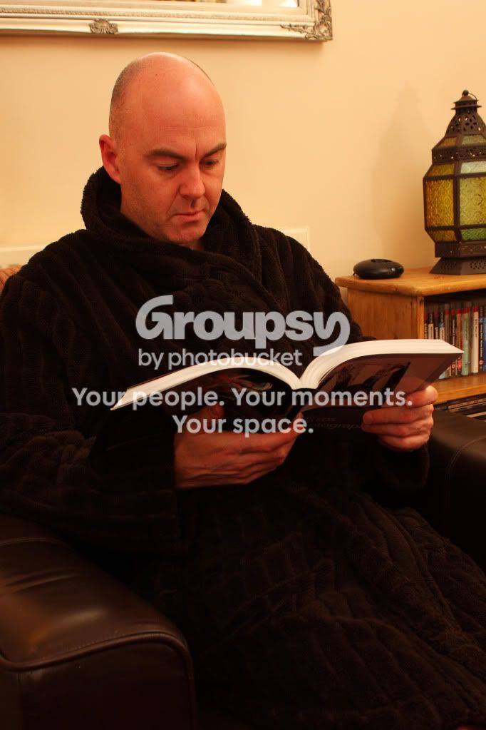

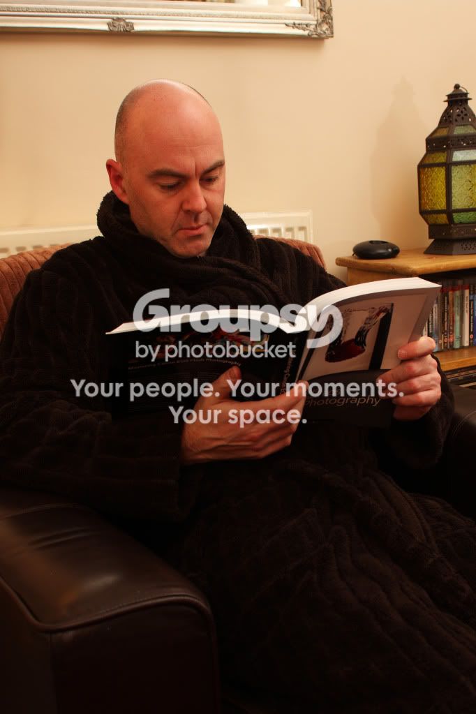

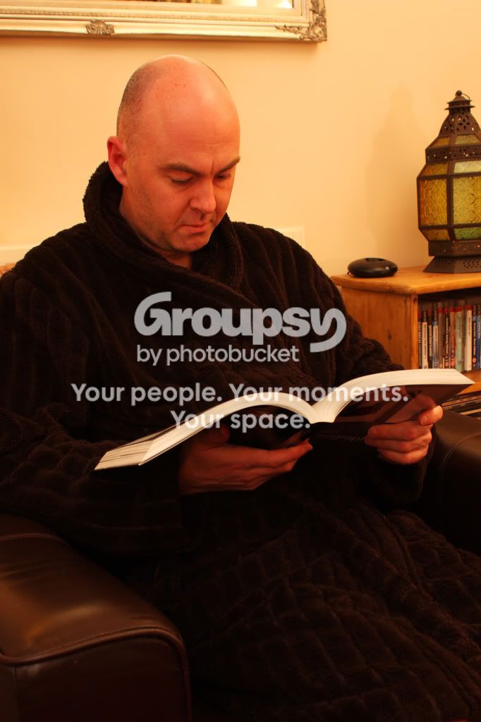

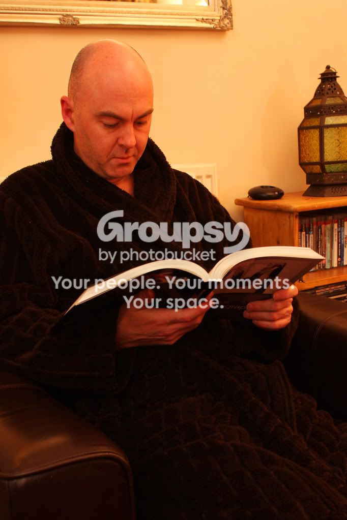

Setup was:
580EXII on camera as master firing to camera left and up
580EX off camera as slave with gel firing up to bounce off ceiling with home made catchligh card in place
Ratio of lights was 1:4 in favour of the off-camera flash.
Photo's with CTO's in place needed some boost in exposure in DPP to bring up to the same light levels for shadows.
1/60th @ f5.6 (ISO 100)
Canon 40d
Shot in RAW
No CTO Gel on 580EX
1/4 CTO Gel on 580EX
1/2 CTO Gel on 580EX
Full CTO Gel on 580EX
Now I can see that as the Gel got 'warmer' it did it's job - what I do not understand is why I was able to alter each photo in DPP using the white-balance slider so they all looked the same....to me anyway.
I thought the point of the gel was to match the colour of light coming off the flashes with that generated from the lamp I was sat under.
To me the ungel'd photo looks better....
