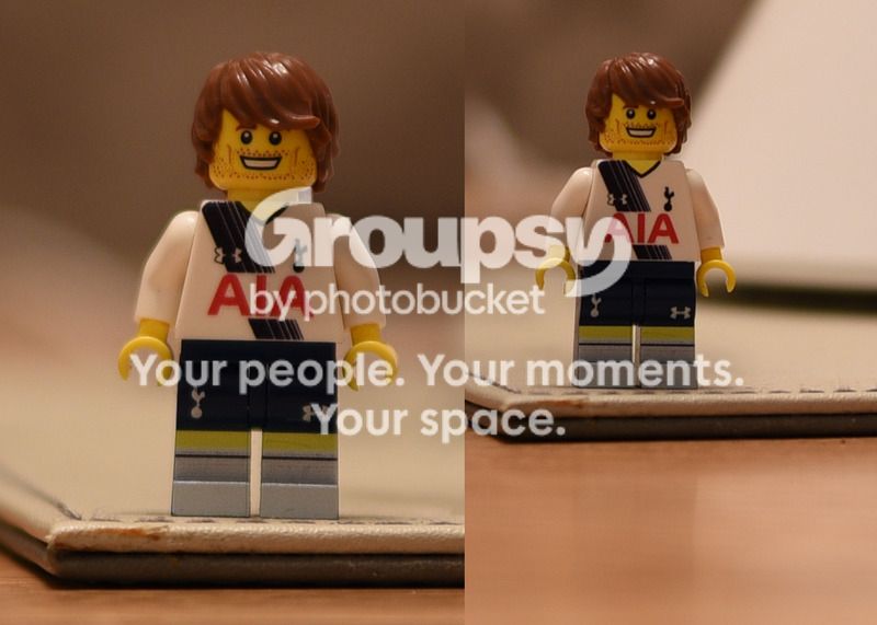

I'm not sure if this is normal behaviour of a prime or if I have some bigger issues?

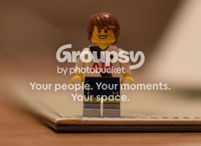

The shots on the left were using the viewfinder, the pics on the right are from live view. As you can see the ones using the viewfinder are pretty rubbish - these were not hand held either.
I tried both lenses and got pretty much the same results... is this what you would call normal behaviour? I'm slightly concerned or maybe these is not really a very good test?

Looks as though the AF is out a bit which is why your camera has AF fine-tune, this is actually fairly normal for a DSLR.
If your lenses fall outside of what can be corrected in camera then you could send it away for recalibration.
The left shot of the 85mm at 1.8 looks more like motion blur or camera shake to me (on my phone).

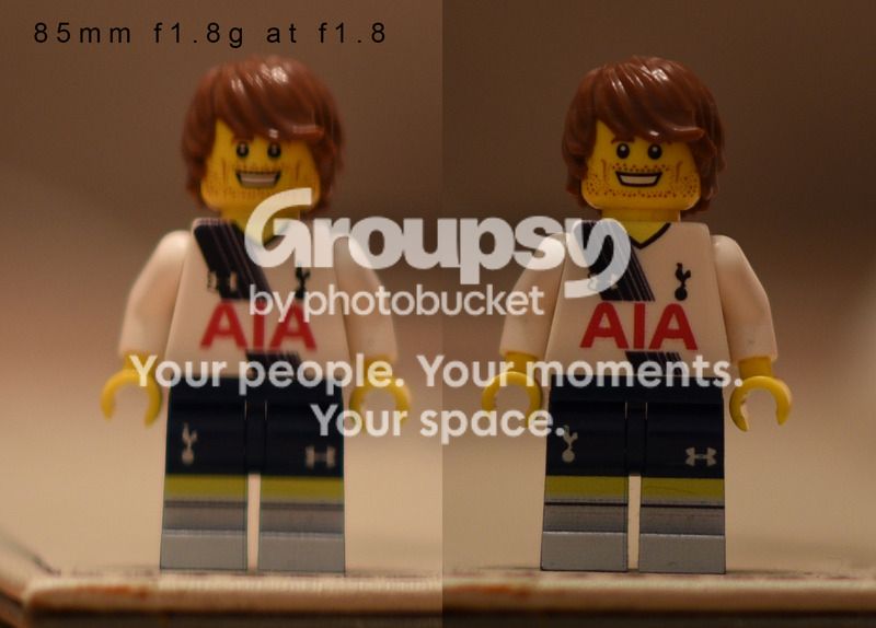

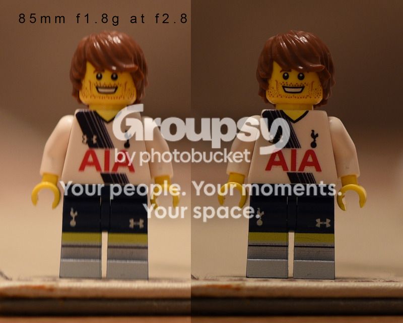

Went up to a better lit room.... results were a marked improvement (actually, pretty decent as these are 100%) f1.8 and f2.8 through the viewfinder(85mm):
The D750 actually focusses well in the dark. You can send the camera to Nikon for calibration along with one or both of the lenses - I have two bodies and use 35 on one and 85 on the other. Both have been back and forth from Nikon til I was happy. I had use of a D3s on which both lenses worked perfectly at 1.4?!?!?!?
I actually think the 85 is not the issue - looking at the original ones there must have been some sort of shake... but the latest ones look pretty sharp on such a small subject. The 35mm however, may need some seeing too!
Looking at the side by side pics in image #2. the base the figure is standing on (left) is sharper than the figure itself, so guess it's front focusing. Try + adjustment in the AF fine tune, but as Ned says it can affect focusing accuracy at further distances.
It's a bit of trial & error really, but try to adjust at a distance you most use if poss.
Yeah, just noticed the base is sharper so think the 35 is defiantly off. The 85 looks pretty good in better light.

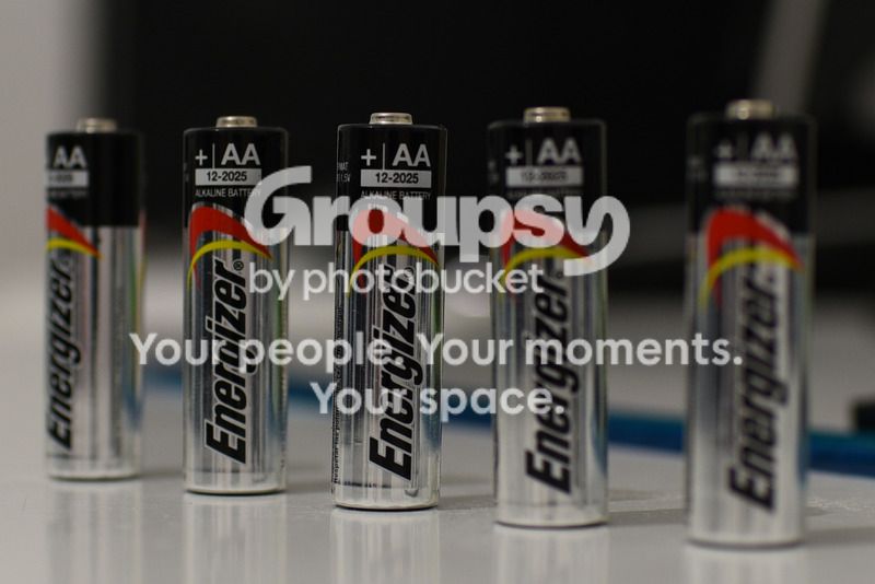

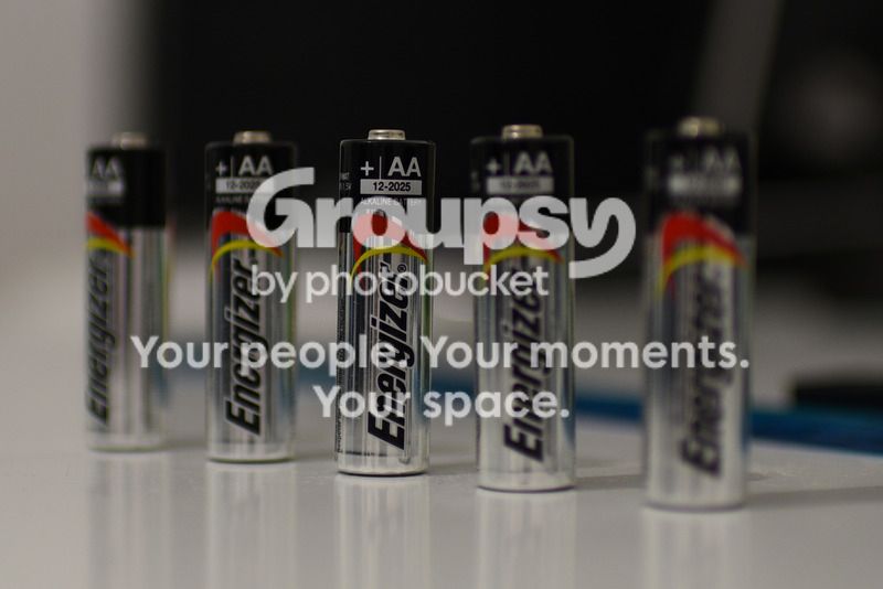

I did the basic 5 battery test this morning. The 85 looked good. I think the problem lies with the 35. Will post when on PC.

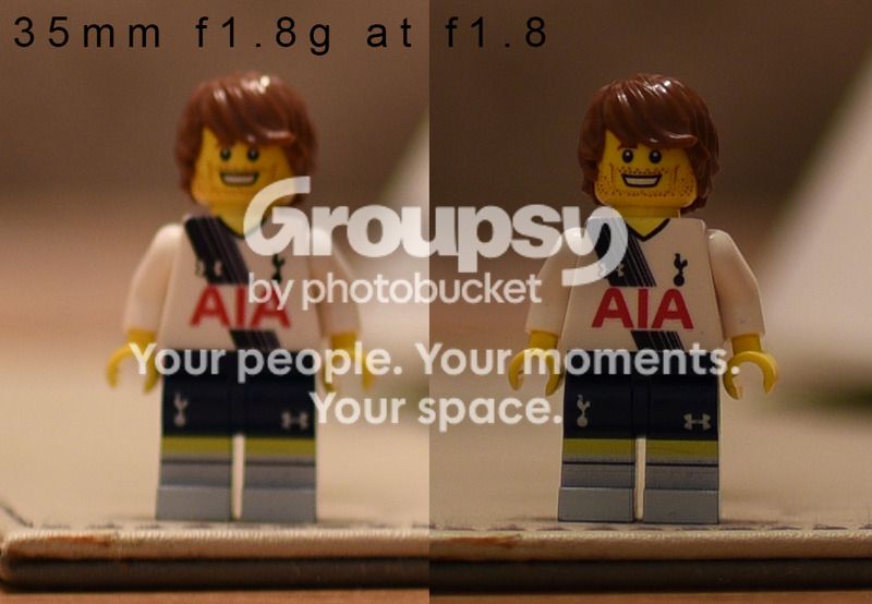

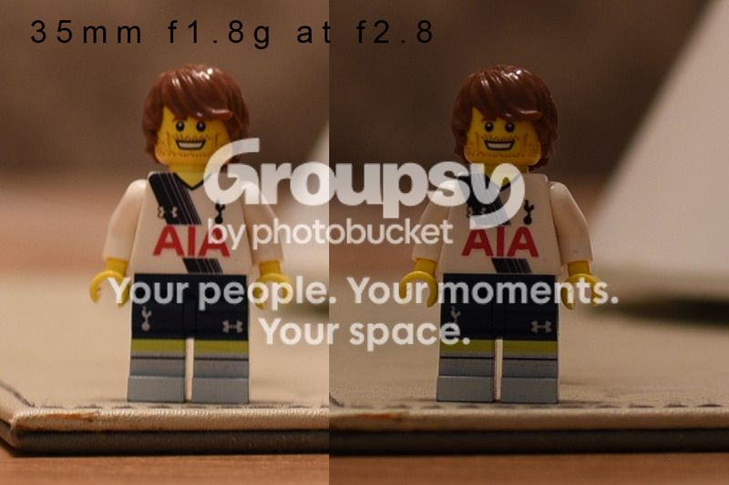

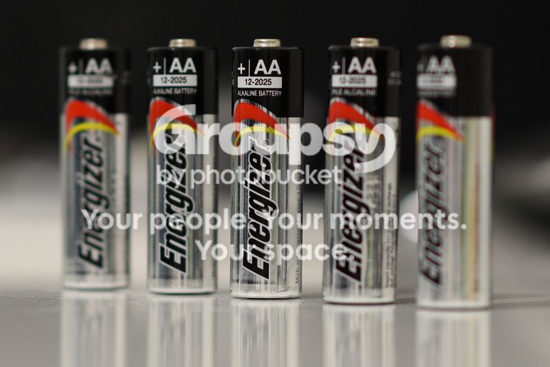

This was the basic battery test, results look better than my dodgy testing yesterday!
35mm @ 1.8 and 2.8
85mm @ 1.8 and 2.8
Those battery tests still seem to be out a little. Did you use a tripod for these tests? Also, you seem very close to the subject and the batteries look very close to each other.
Have a look at this if you are going to try the battery method > http://cameralightlens.com/newsblog/?p=264
I used above methods and pics are cropped. Batteries are actually further apart than they look and at 45 angle.
I actually took camera and lens to place of purchase today and they happily exchanged the 35mm for another. We tested in shop and its much much better.
The 85 looks pretty good so not going to mess around with any adjustment just yet until I start getting some pics done.
