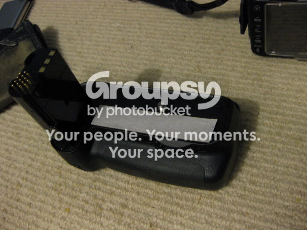

other have the same problem .
http://www.flickr.com/groups/nikond90club/discuss/72157610233869526/?search=MB-D80
there is a cardboard fix you can try :

Sounds like a well known and acknowledged (by Nikon) problem, which is dead easy to remedy. Remove the grip and take a look at the centre battery contact pad. There should be a nice clear mark somewhere near the middle where the pin (actually spring loaded, pointed blade) in the body makes contact. What you might find is that the contact mark is close to, or actually at the edge of, the pad. If that's the case then just carefully adjust the body pin to centralise it again and hey presto! No more problems.
The middle contact is the battery sense which the body uses to gauge the amount of charge remaining.
Hope that helps :)

See what you mean, the older battery (used pre grip) the middle contact marks have been seen left slightly toward the edge.
Made adjustment, lets see how it goes....really irritating little problem. Cost me a dew good photos today :(

I dont think i've sorted it, but i do think that's the issue.
Getting the pin in the position (and sort if staying) there proves tricky
Had a weekend of not using the grip plus using my 3rd party (so newer, and unknown quality) and no issues.
Definately what you say it is, also hearing people usining tin foil around the pin to increase connectivity. My pin seems very stubborn :). One way is easy to bend, the other (the way i need it) is tricky
