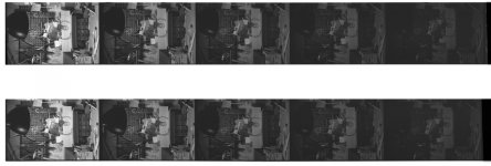

On a day with "stay indoors" weather, I set up a test scene indoors and loaded my Cosina CLR SLR with twenty-odd frames of Fomapan 100 and took a series of exposures.
I metered my scene and chose a sequence of: one stop overexposure, correct exposure, one, then two, then finally three stops underexposed. This series of five frames was repeated to the film end, giving around 4 sets of the sequence. The sequence had the film speed set to 100, at f1:5.6 with shutter speeds from 1/8 to 1/125 (on a tripod, using cable release).
The film was separated into two lengths and developed separately, the first piece in Rodinal 1:50 for 8 mins @20c, the second in DuoStep parts A & B for 4 mins each also at 20c. A set of five consecutive frames was taken from each and scanned. The results weren't as expected:
On my Epson flatbed scanner, a scan of the neg strips (both in the same pass) gave this: (I should add that with the scanner software in "pro mode", no auto compensation is made to the scan).
DuoStep is the top row.
As regards general negative density, there is very little difference, if any. Not what I had hoped for.
I wonder if my choice of film does not work well with DuoStep?
