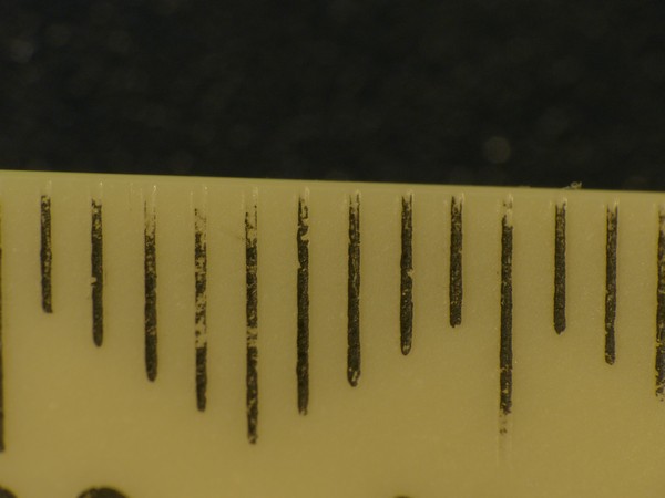

I'm glad we agree about the facts. Now, as you rightly point out, the issue is relevance.
I am not arguing that the 1:1 definition of macro is wrong. It is a very good definition, being clear, unambiguous and precise. My issue is whether it helps to clarify things for a beginner or confuse things.
This image was captured with a micro four thirds camera, with the scene filling the frame. It is a macro according to the "at least 1:1" definition.
13mm wide scene filling the frame on a micro-four thirds camera with an 18mm wide sensor
by gardenersassistant, on Flickr

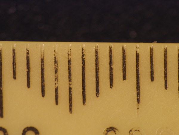

This image was captured with a super-zoom bridge camera, with the scene filling the frame. It is not a macro according to the "at least 1:1" definition.
13mm wide scene filling the frame on a super-zoom bridge camera with a 6mm wide sensor
My contention is that a definition which regards an image as a macro or not a macro depending on the camera it was captured with can be misleading, and that knowing that is both useful and relevant to the question asked.
I believe that a definition which can produce ambiguous real-world results (as in, Question: "Is this a macro?", Answer: "Possibly, it depends on the camera") can serve to confuse the person trying to understand what macro is or isn't. That is why I don't use the term "macro" in relation to my images, as it can be confusing.
There is no formal or technical definition of macro or micro photography. Neither is there a simple explanation that fits everything, as the OP is now discovering.
The old 1:1 reproduction ratio definition (though that is not set in stone either) is vested in 35mm film, and as Nick points out, it's not very helpful when smaller formats are involved. And that includes the majority of users, so explaining the differences there is very relevant.
