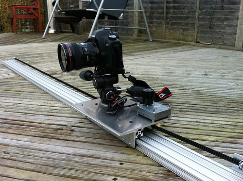

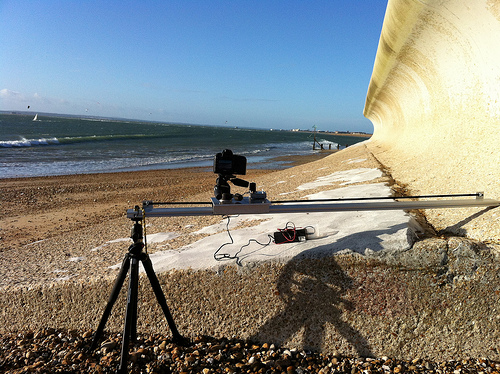

Here is the setup and a shot of it in action

I also have a telescope motor mount to track the skies which I hope to mount on to the cart for some night work

Don't suppose you have any more pics of the rig that moves on the rail? Are there wheels on it etc? I don't mind having a go at drawing up a template if I see some pics..
Thanks
Adam
Got to admit I am tempted to have a go as well so any more info you could share would be greatly appreciated.
