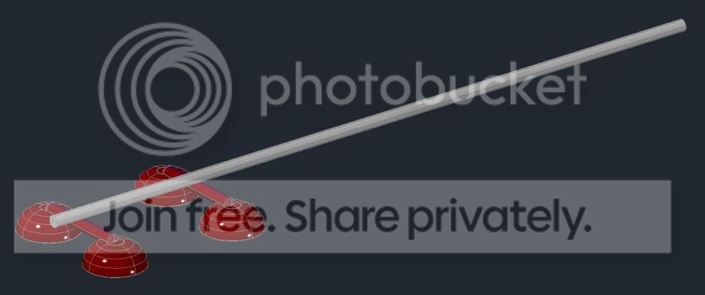

Excuse the poor 3D model, had to rush it in between doing the day to day stuff.
That's what I was thinking of in basic principle.
Items:
2 x Dual 60kg Suction Lifter (RRP around £7.50 each)
1 x 2 or 3m Telescopic Aluminium Pole
All necessary Nuts / Bolts and Clamps
Then have the arm on the end for the Camera etc.
Might seem crude but could be very effective and low cost.
