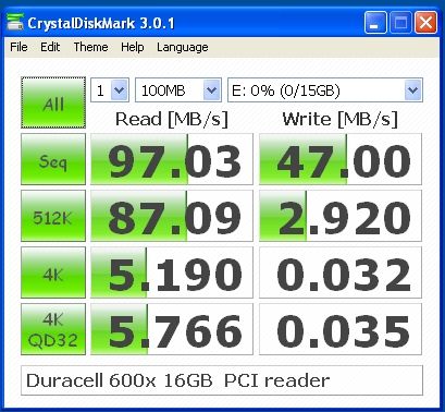

As for the Duracell (which are really Dane-Elec with a different label) the 600x refers to the, fairly irrelevant, read speed. It should be 90 MB/s but, as these measurements show, it doesn't get that fast - more like 80 MB/s. And the write speed is even worse - less than 60 MB/s. So they're not even 400x.
Duracell are attempting to deceive potential purchasers. If they're going to be shady about their card speeds what else are they going to try to get past us users? I wouldn't touch them.

I've found some test results and as hollis says...the 90MB/s is more read. But 47MB/s write on a 32GB card, that cost me £60, is ok by me :) Yes, I went for it in the end lol
I was worried they'd be something like 20MB/s write.
Granted...this is for a 16GB which would likely be faster:
I dug around before buying but I do feel for those who buy thinking they'll get 90MB/s write. And agree with hollis, again, that it's deceitful. :rules:
