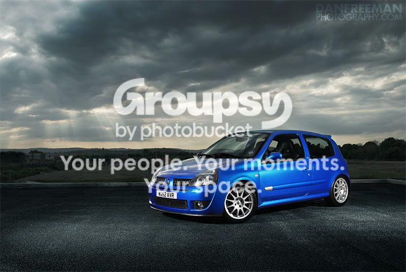

for example dan freeman has some nice work and isnt with a massive spec system
obviously i didnt look for the budget set ups because they dont seem to have such a good flash duration as the elichroms
Lovely shot of the blue Renault by Dan Freeman. He's obviously done that when the ambient light is low, so no problem with flash power. There has also been a bit of Photoshop smoothing out reflections on the car.

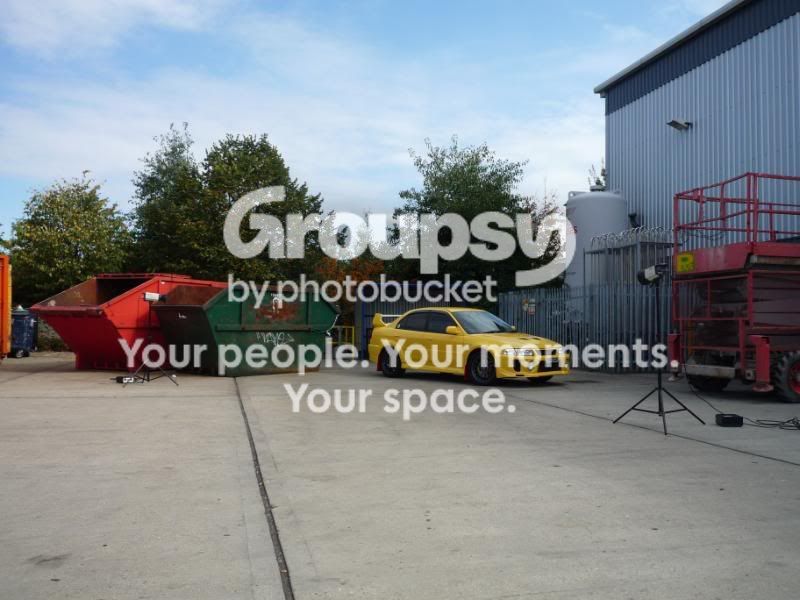

What is the yellow Evo shot telling us?
