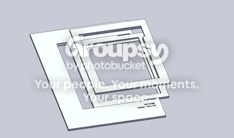

It can't, I scan 5x4 in two scans and stitch using this to hold the film..
Designed and made by me when I should have been working....
