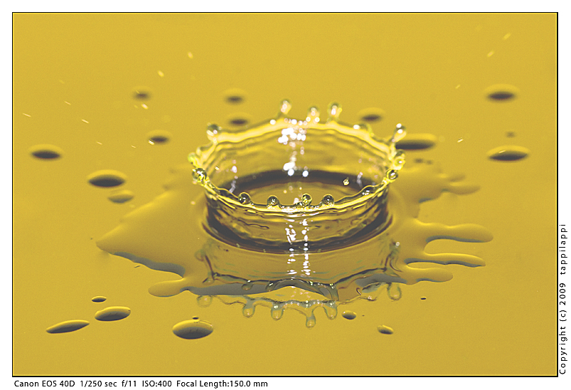

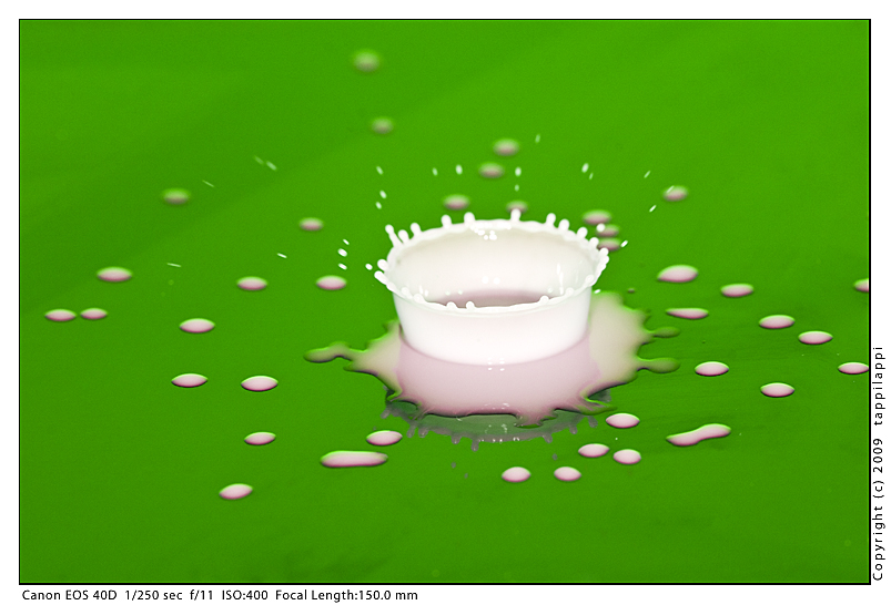

Definitely use a tripod. I tried one of the electronic flash timer things, but gave up and went back to manually tripping the shutter as the drop landed ... I average about a 1-in-10 success rate. I also use a piece of coloured card behind the scene, the flash bounces back off this and "colours" the whole area. Also you do not have to drop the drop into water ... I use the black surface of my ceramic hob - get the angle right and it blends into the background. A couple of examples below - quality is not brilliant as the pics were just shot to show someone else the method (a few more on flickr if you are really desperate ...)
