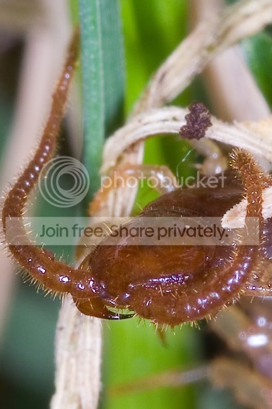

Tubes will work to varying degrees with any lens. I have the Sigma 105. Depends how much magnifaction you need and that depends on the size of the subject. Here's a centepede's head I took with the 105, last week. Gives you an idea of what it'll do.
whoa, nice one.
Is that with just the 105 or with ext tubes?.
Rob
Just shot in RAW with the 105, then cropped in a bit in PP and sharpened etc.
