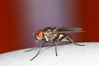

I took the following image hand held with a 105 (yes it was a Nikon one BUT I am comparing lenses to tubes). There was no real setup I was actually reviewing the Safari ring light system rather than the lens.
The quality is FAR better than you get with tubes. Basically the tubes work by moving the focus point forward so a larger image hits your sensor so if the image is 10 times as big you only get a small part of the light actually where it matters. This makes it darker and means you need a longer exposure. This is ok if you are taking an image of a total still item but makes it more difficult for insects etc. (sorry i'm giving you the non scientific explanation)
This is not even a particularly good example! It is not quite in focus but I think you will get the idea.
1Mb version
1.5Mb version full frame
