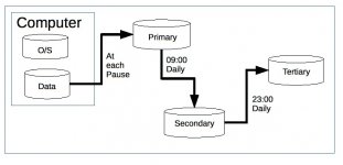

I don't have any problems but I don't use Time Machine - I just don't trust off site backups. Instead I have three drives labelled "Primary", "Secondary" and "Tertiary" and a copy of Carbon Copy Cloner, which I recommend for its simplicity and reliability over the last 10+ years.
"Primary" is backed onto "Secondary" once an hour After the initial backup which happened years ago, it takes a couple of minutes to update. I then back "Secondary" onto "Tertiary" once a day. Here's a very simple flow chart of the process...
