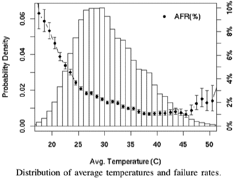

Bizarrely it is the reverse to what you might expect.
Google did a study 5 or so years ago and came up with this graph:
(see it in context here: http://storagemojo.com/2007/02/19/googles-disk-failure-experience/)
The blocks are number of disks at that temperature, the points average failure rates at that temperature.
Unusual findings....... But I think the 50 degree limit is slightly hopeful, i've seen shop bought external drives get too hot to touch, that's certainly higher than 50 degrees C.
I've known HDDs inside laptops to reach near on 65 degree's (when used on a lap or soft surface).
My 2.5 external runs most of the day and sits at around 30-40C and that's with a full aluminium case, positioned partially over the top of my PCs exhaust fan.
Commercial electronic components generally have a limit of 70, industrial 85, military 125 and so on into orbit. So I think the boys at Google should have extended their temperature range a little.
Google will run in aircon'd data centres - hence the peak around 25-30.
The point is, some heat is good for drives. I have my HDD fans set to come on when temps reach 37 when reported from the SMART settings. I don't have enough drives to make a statistical calculation though :)
