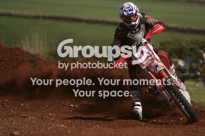

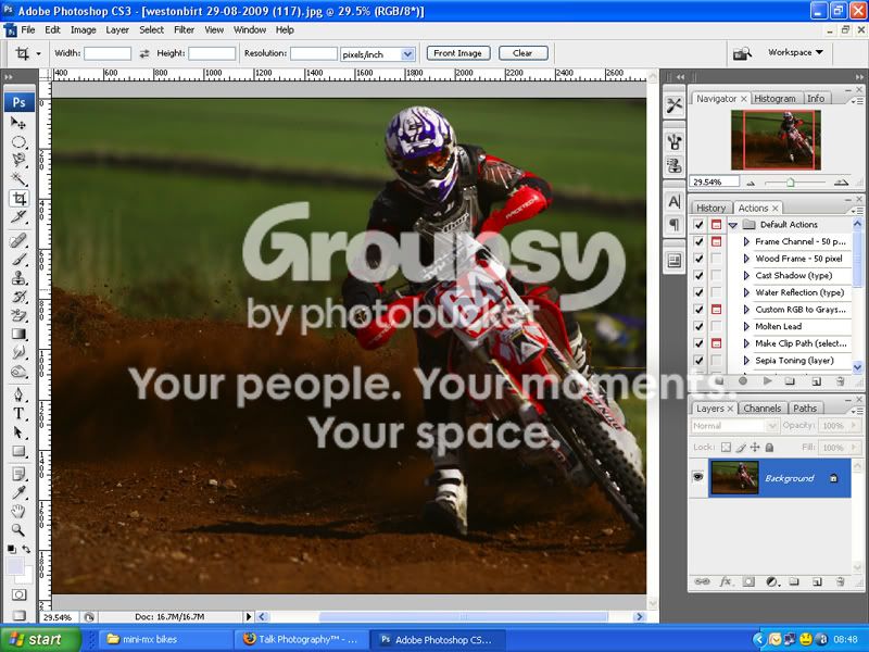

When I save a jpeg image in CS3 the saved jpeg seems much more faded that the original??
I'm hoping its something I'm doing wrong, or am I being really thick here?:banghead::banghead:
1.
How it looks in CS3.
The saved file.

Spence, it's because the image is in AdobeRGB - you need to switch to sRGB and the problem will go away.
