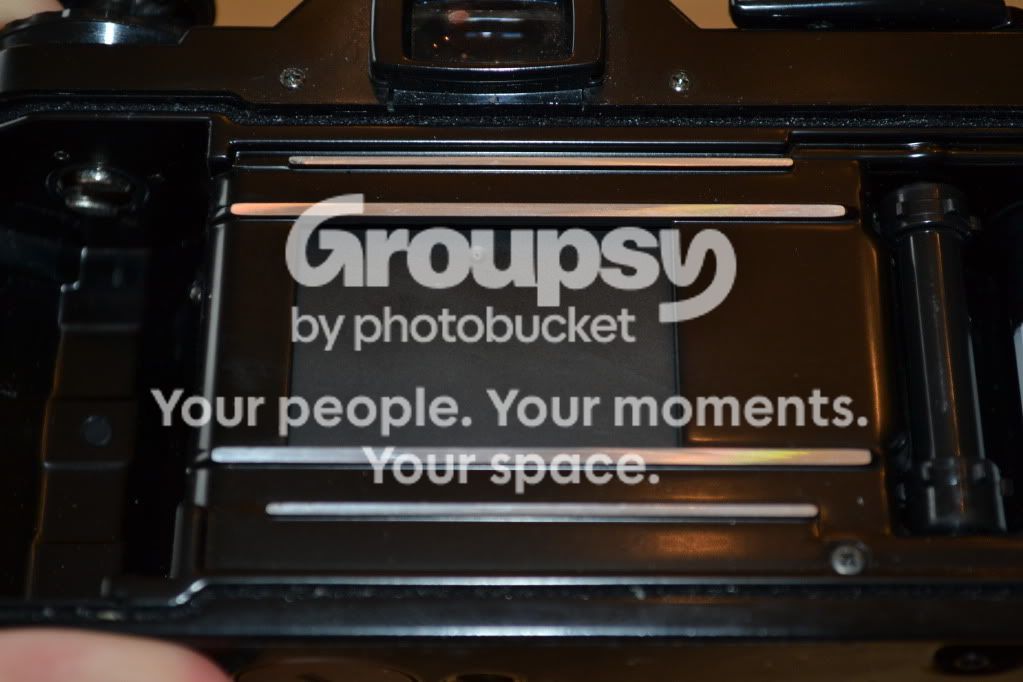

Ok, So i opened up the camera to put a film in and realised the little screen on the inside had cracks in it like so:
Now, is it meant to be like that? Bearing in mind I have never opened a film camera in my life! Thanks in advance.
Don't panic, it's fine - it's called a leaft shutter, they're little metal blades that fit together really tightly :thumbs: Press the shutter release with the back open and you'll see it all work, just keep your finger out of there!

Just a technical note - this isn't a leaf shutter. It's a focal plane shutter, and the individual metal bits are part of the shutter curtain. Most obvious way to tell is that if it was a leaf shutter, it would have a higher than 1/100 flash sync speed (leaf shutters can sync at all shutter speeds). Pedantic, I know.
Or more specifically its a vertical run, metal focal plane shutter.... :)
Aren't leaf shutters on lenses too rather than bodies? (not trying to rub it in, lol, just a general question)
Both - leaf shuttered lenses are on several medium format SLR systems, leaf shuttered bodies are often on TLRs.
