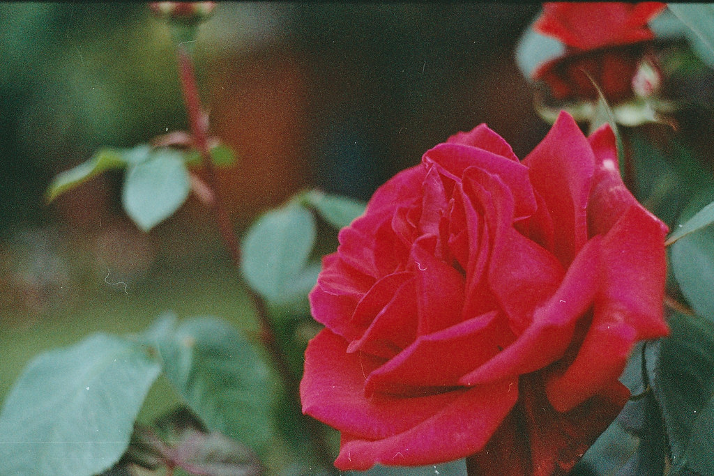

So here's one of the better ones:

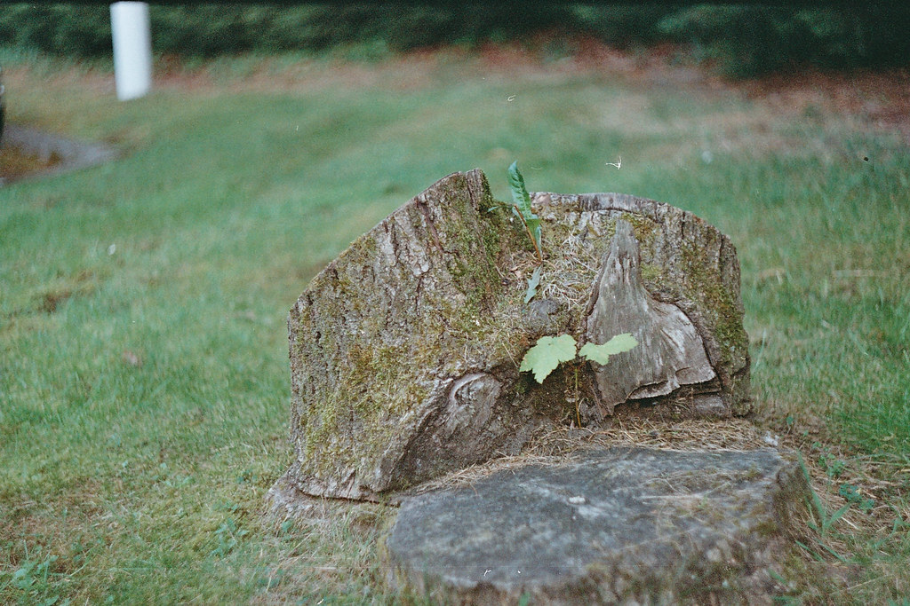

Less better ones:

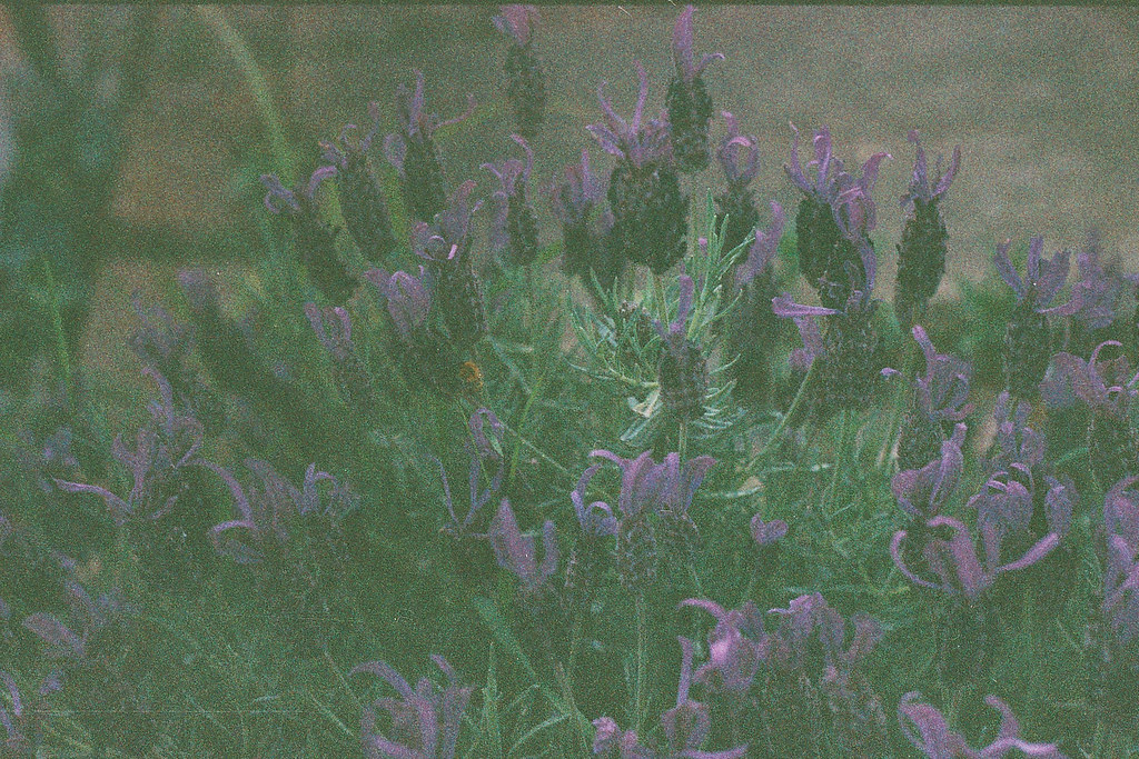

And truly shocking:

Hi Chris
1st image " I'm stumped " :lol:
All I can say is get a roll of in date film , SLOW down and do it by the book
Pick different apertures from F16 down too F2.8 on several different subjects from landscape s at F16 to some close up image making sure the focus is correct at F2.8 say a flower
Have a crack at it
Good luck :)
I don't think there is anything wrong with the second one personally, it's a bit grainy but that's ISO400 film for you.
The third is underexposed and the scan has boosted the exposure making it grainier.
Doesn't seem to be anything sinister :thumbs:
