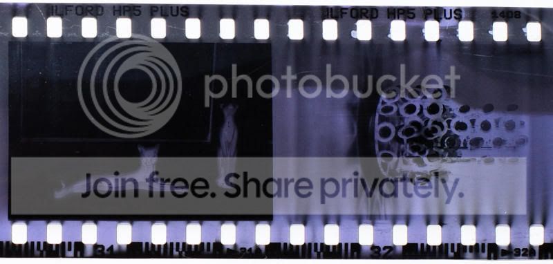

Finally got my film developing kit today and had a first attempt with a 35mm roll I shot (nothing important on it!)
I made a stupid mistake - got my calculation wrong (don't ask me how :bonk and used 1:15 ratio on all chemicals instead of 1:9, but used the time for 1:9.
Another stupid mistake - After hanging up the film, I used some soft clean cotton wool to help dry it. Which was fine at first - but as soon as the film started drying, it became very sticky and sticky+cotton wool=:thumbsdown:
Also there are a couple of scratches - so I won't do that again!
And I have learned that I need at least three measuring jugs/containers - agitating with one hand while mixing the next chemical and getting the temperature right with the other does not work
Anyway, surprisingly it appears that all of the pictures are clearly visible on the negative. But there are two problems. I took a photo with the film placed on white paper to show them (not got scanner yet):
First problem - what's up with the sprocket holes "leaking"?
Second - the top quarter seems to have some kind of odd light/dark wavy effect.
Any ideas what (else) I did wrong?
