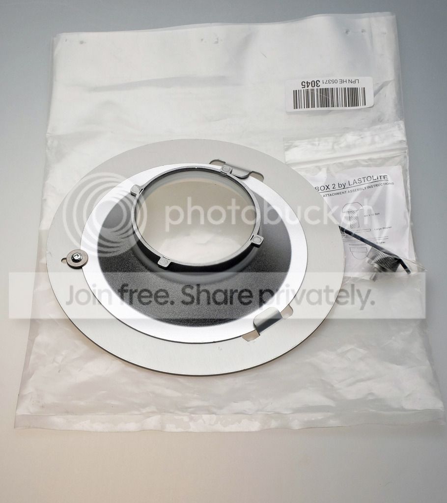

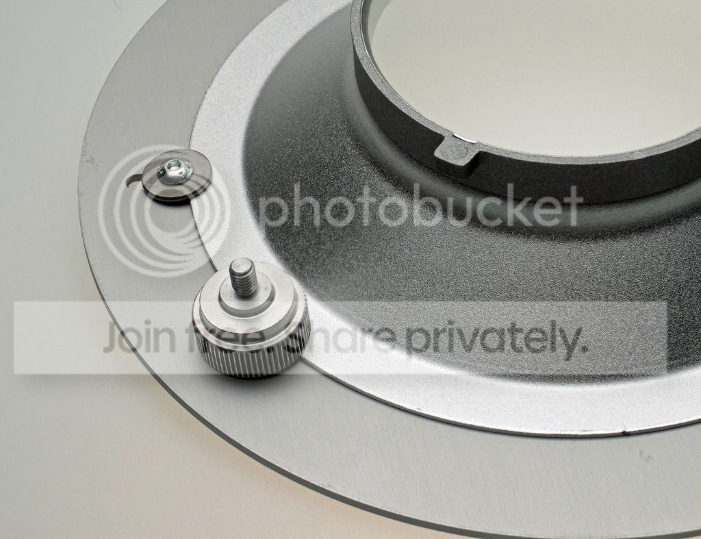

First thing that needs to be mentioned, is it comes with a back-plate, but you'll have to add in the price of the speedring (or flash bracket for speedlights) and this adds over £30 to the already rather high price (IMO) and in the case of a studio flash we are just talking about a stamped out ring of metal which comes with a standard 154mm adaptor, plus a small bolt and a machined finger lock bolt.

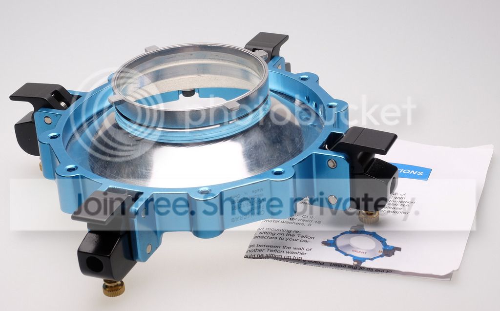

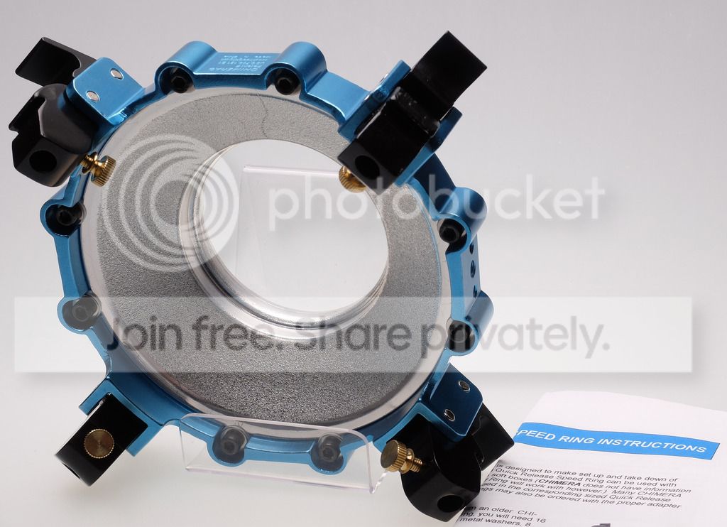

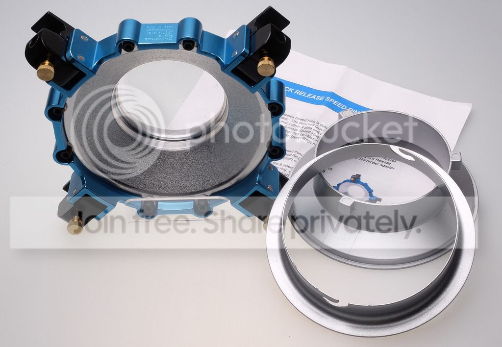

So what else to say about these softboxes - oh yes the issue of the speedring price! Well the average online price would appear to be £36 and for this you get;

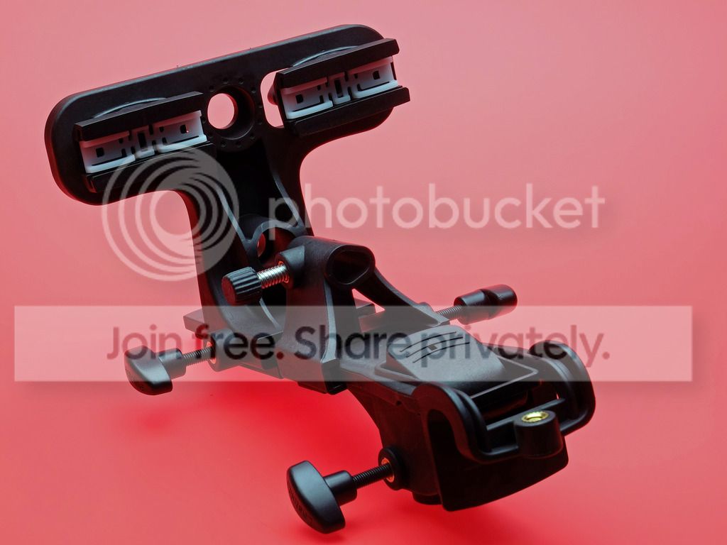

which as I stated earlier I feel is very poor VFM, now if you're a speedlight user, the same £36 gets you;

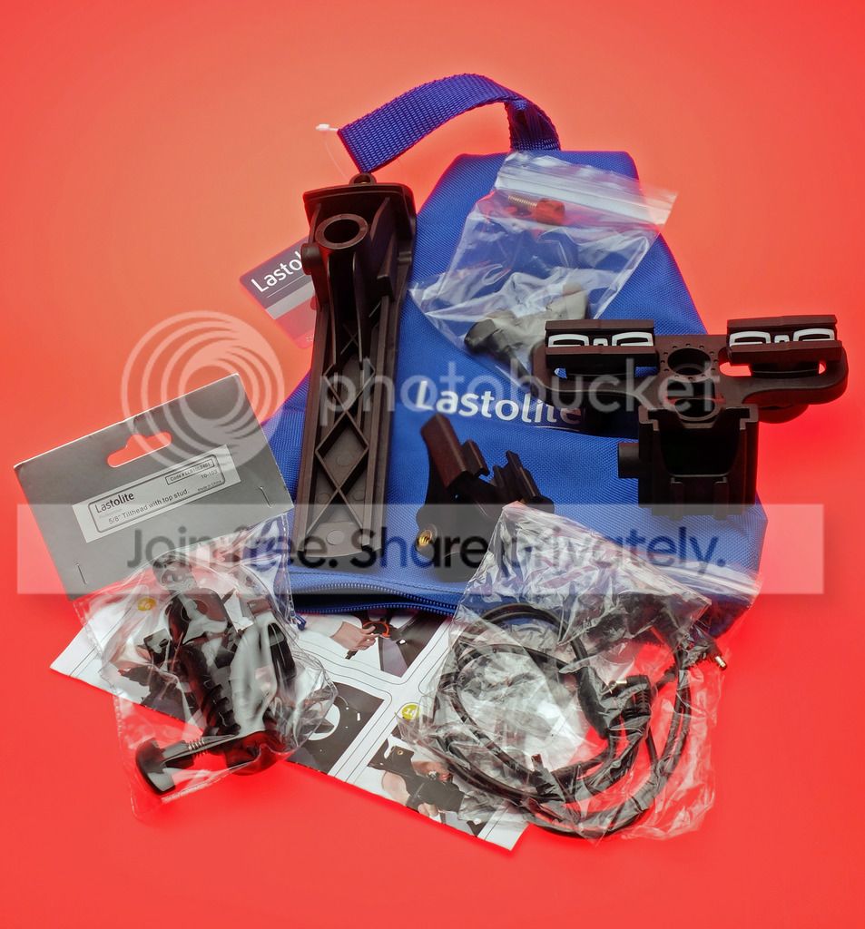

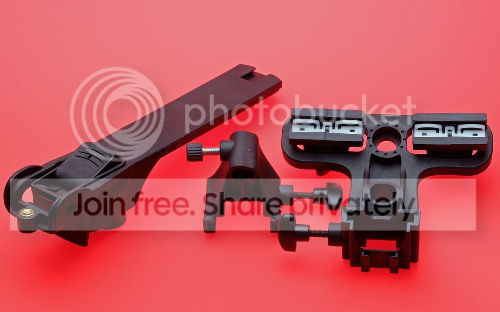

So a nice canvas bag instead of a carded plastic bag, the main twin light bracket components, two types of lead and a stand tilthead/umbrella holder (these used to cost about £20 on their own) now that seems great VFM! The speedlight bracket came as part of a package deal with the XL version, which I opted for as it was cheaper than buying the stand alone softbox :thinking: well not being a speedlight user this will be ending up on a certain auction site shortly.
