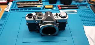

I've been buying and selling cameras since the mid 1990's, usually when I'm not busy doing my photography, before this one, I'd give them a good clean, and make sure there working perfectly, but this one needed a little bit more work than a clean, although the body was clean, the spring was weak in the film rewind knob, the baseplate was scratched, but mainly the prism was corroded, if you have the OM1/OM2 that hasn't been affected, your very lucky, or it's been corrected, the only option is a new prism, luckily all OM's even the later 10,20,30 &40 share the same prism, but they didn't use the foam that corrodes.
First the top cover has to be removed, there's a few videos on YouTube that shows it better than I can explain in words.
This is what the corrosion in the viewfinder looks like

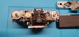

With the top cover off, you can see the corroded foam
The hotshoe bracket needs removing, all the black gunk needs removing, it's not a nice job, but I took it slowly, and a final cleaning with Isopropyl alcohol on cotton buds and sponge applicators, I removed the focusing screen, as it makes it a little easier, although I replaced it, as it did have a few marks on it

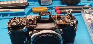

After putting it together, time to check the meter, even though it was working before, it was dead, so without panicking I started at the source, and there was the problem, broken wire at the battery box, luckily I have other cameras to strip bits from, all I needed was a short length of wire and a small plastic tube, looks like I'll be soldering later on 20251116_130345.jpg20251116_124014.jpg

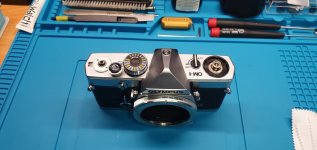

After putting this off for a while, bought a new soldering iron, solder paste and flux, and after what seemed like a lifetime, I managed to get a good joint on the battery terminal, I had to trim the original wire a bit as there was quite a lot of green verdigris on it, but after it was all put back together, I'm was pleased to find out that the meter works.

The brown wire runs inside the body, all the way through the camera, across the front of the prism, and then to the On/Off switch, something I didn't want to do after replacing the prism before finding the meter didn't work afterwards, I might have disturbed it while doing all the work, as I did move the brown wire out of the way a few times.20251110_205045.jpg
