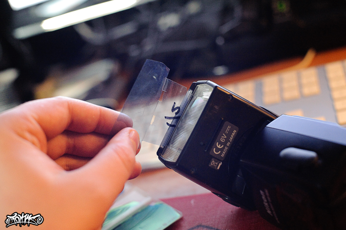

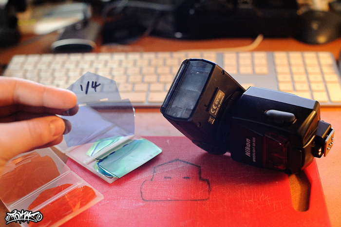

If your not relying on sample/swatch pack size gels then I recommend cutting them in a similar way to this:
Template scribbled on a cutting mat in sharpie, Buchanan style :cool:
Insert in the thin slot in between the wide angle panel and bounce card.
No velcro, holder, gaffa :cuckoo: or any additional appendage or accoutrement needed. Works with Nikon, Canon, Jessops flashes etc.
Provided you score the fold line tight enough, not even a gale force wind could knock it out. In the sample image you can see small rectangular holes, these really help get a tighter fold on the thicker gels.
Doubling them up is a piece of piddle too, if needs be. :thumbs:
