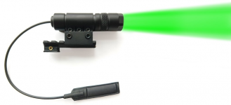

That's a bit strange, you would think the likes of Godox would be on that already, but yes live view is off, Godox do a little light that might work, I would have to put the big cage back on for a mounting point.
I have a little tactical light that has a picatinny/weaver mount on it and a remote pressure switch. I have it on a hotshoe mount which can be put in the passthrough hotshoe of a remote trigger. I also have a small arca swiss clamp mounted picatinny rail so it could be mounted on an L-bracket or arca swiss plate below the camera.

I've seen one that can be mounted to the flash itself and uses an optical sensor over the AF assist light on the camera body, but that also has limitations; must use AF-S with Nikons and it's not very powerful (may be more than adequate, IDK).
I've considered modifying the flash's window by creating a green window in it... but the mirrorless cameras won't activate it anyway (at least Nikon's don't).
