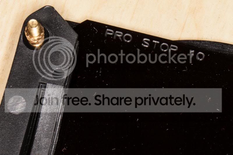

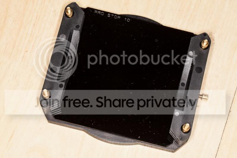

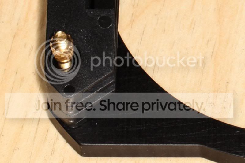

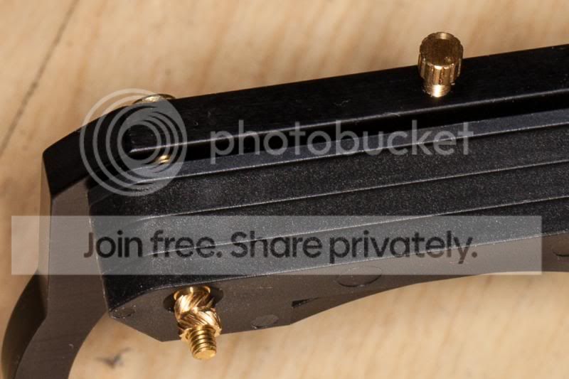

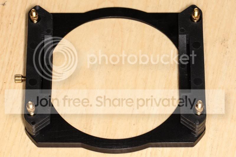

Firstly the holder itself is modular, in that you can add and remove 'layers' as necessary. It's well finished and well constructed, and comes ready assembled for a 3 filter setup. It also contains a few spares in the box just in case you lose a screw.
The images above show the filter holder, and it's brass screws holding everything together. The idea being you loosen the screws to insert the filters, and then tighten again to hold in place.
This works well in principle with the 10 stop, as can be seen here:

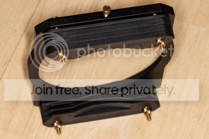

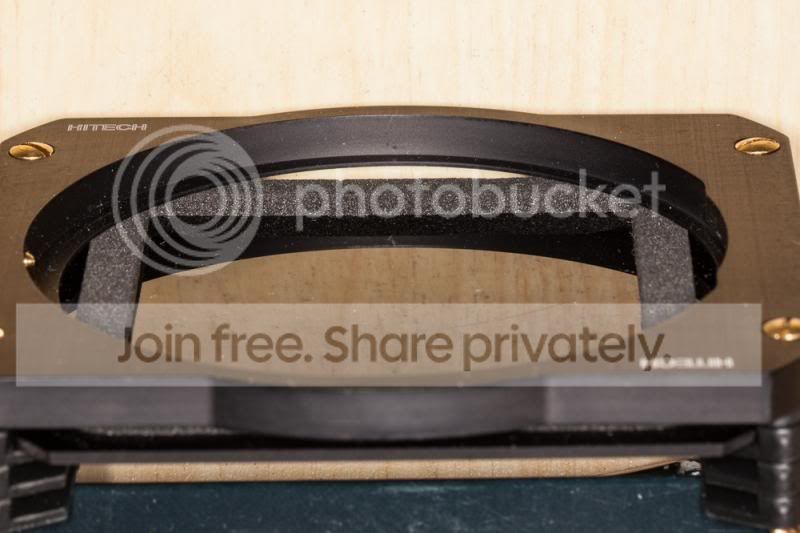

However on turning the filter holder over, it becomes obvious that the gasket doesn't fit the holder, and light can again leak through.
I've written to Hitech, and they've promised to send me out some gasket material (although it's not arrived yet).

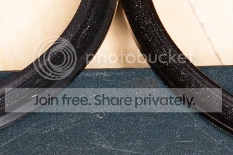

Another question I had in my mind when purchasing, was whether my existing Cokin adaptor rings would work with the Hitech holder, and on receipt of the Hitech ring, I can see that it is different. It has a bevelled edge, that allows the use of the thumbscrew on the filter holder, to keep it in place. This is a perfect fit, whereas the Cokin screw doesn't really sit well in the holder, and there's no ridge to hold it in place - so anyone with Cokin rings will have to buy Hitech ones instead.
The ring on the left is the Hitech one, the ring on the right is the Cokin one. I think you should be able to make out the difference between the two.

Don't forget you also have the width of the adapter ring to fill that gap between the gasket and the filter holder - that should seal any light leakage.
Your photo shows the holder with no adapter ring fitted.
You're right - but when the ring is fitted - the gap is still there :) Formatt said tonight that extra gasket was on the way :)
I have the 100mm Hitech holder but use a Lee Big Stopper in it instead of the Hitech Pro Stopper. The gap is there without an adapter in mine but the ring covers all of the gasket on the Lee filter so its not a problem.

I didn't realise they were based around where I grew up and went to school.. Their customer service guy explained that some of the earlier 10 stop filters were designed before the newer holder, and so didn't have enough gasket - so they happily send it out FOC to anyone that finds they need it. (Although they forgot - and have promised to send it in the morning).
