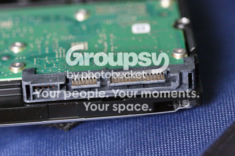

I have taken the drive out of the casing is there a lead that I can buy so that I can connect the drive to a usb port
I use a laptop and I dont want the mess with the wifes PC !:D
sorry to hear about your computer steve hope you can recover your data
depends if its IDA or SATA, maybe a pic of the drive connections up here will help if your not sure ?
ebay has thousands of cheap cables and usb-hard drive cases, if you can confirm what the drive is i can give you some links.
Thanks gonzo here's a pic of the connections its a seagate barracuda 7200.12 500gb
Thanks very much gonzo for your help thats brilliant , have ordered the caddy on your link:)
With a bit of luck the drive itself is Ok its worth trying anyway:)
Thats a SATA drive, and if you get a docking system they are really cool, just make sure its a fused plug!! Lol. My hdd's should be fine thx :)
