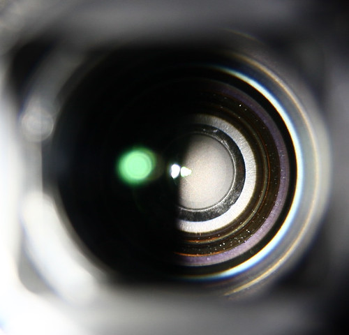

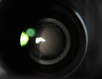

issue 1.
there seems to be some kind of lens cap, inside. its blocking the lens and no light comes through. when i put on the ND filter, i can see the nd slide infront of what looks like a matte black sheild. no image is displayed on the back at any point and when a pic is taken its totaly black. whenm in manual mode the light meter jsut reads under exposed all the time. im not sure if it is some kind of internal lens cap, or part of the shutter mech.

this is with the camera on and zoomed all the way in, torch shone in and pic taken with my 40d

I have a G11 and have never come across this...
But, if you are prepared to try a self repair, G11 lens units often come up on ebay so you could try replacing that?
Im just not sure what to replace, its almost like its 'sticky'
