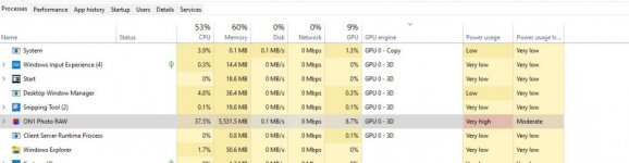

However, before buying anything, I suggest opening Task Manager's Performance tab then running On1 to see which component is maxing out. The value of the On1 forum can be judged by this not being suggested there.
Hi, OK I reinstalled On1 and on opening an image from Browse this is the usage, now I am not a computer wiz but the CPU and memory look higher than anything else.
It's more useful to click on the performance tab at the top so you see the totals for CPU, Memory, etc. rather than by process.

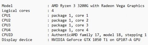

That's an expensive option and not really necessary. Having had another look at your PC configuration, the CPU seems to be the weak link as the Ryzen 3 3xxxG CPUs are not strong performers. Dropping in something like a Ryzen 5 5500 or 5600 should have a dramatic effect on performance. Make sure the motherboard BIOS is up-to-date first, though.

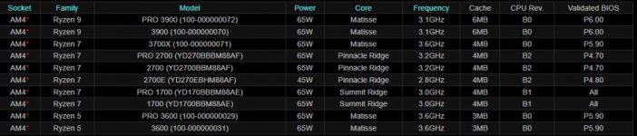

According to the chart attached it states at the bottom that the bios needs to be P5.90 for the Ryzen 5 3.600 or that is what I am understanding.
Also understand if I put the new CPU in and it is not working because of the bios I would need to reinstall the old CPU
