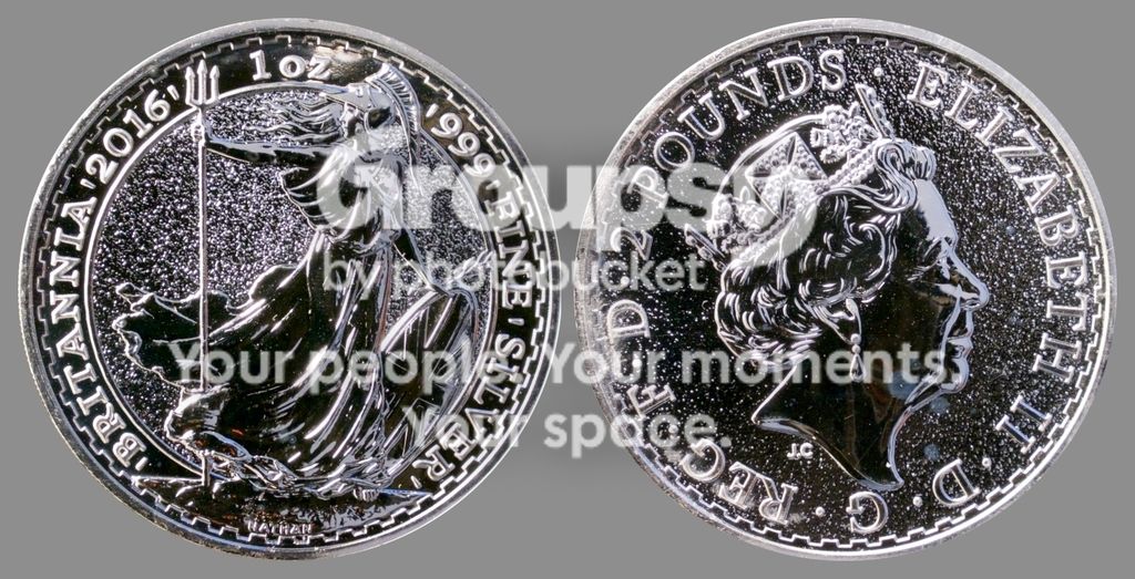

Look at this picture of a 2016 Britannia:-
Would you know that it was wholly a silver colour from the photo? Certainly some areas would look far better with the light bouncing differently.

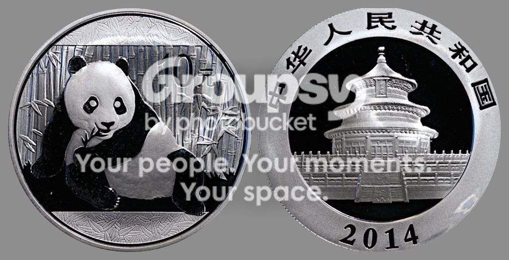

Now don't get me wrong, the error sometimes works out for as with this 2014 Panda:-
The Panda accidentally looks right and the temple and stairs also are fine. Please understand that win the hand both the Britannia and the Panda look like shiny silver with frosting and etching.

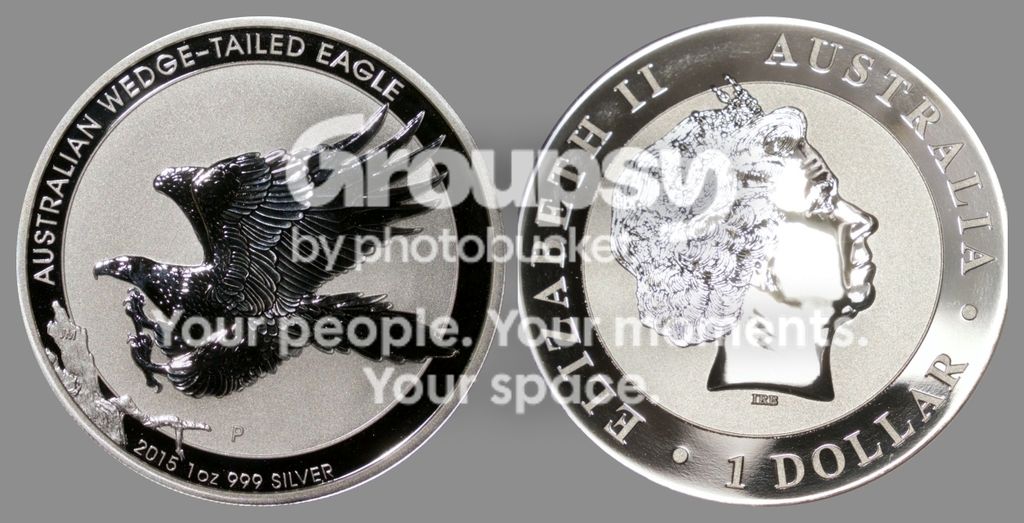

The problem is that the frosting bounces the light in all different directions so what is right with one is wrong with the other. The texture in the eagle is better with the cross light but still not silvery. The Queen is (overblown) silvery but the majority of the inner rim is black.

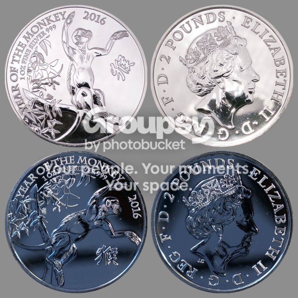

Decided to have quick go before turning in. Tried a couple of things - but the big difference came by cutting a hole in some white material and putting that over the lens, then tilting the coin towards the single light. The first pair is with this technique, the second row from the last time I tried. Not perfect but lots better. Thank you all for your advice - I now have a far better idea of what I was doing wrong.

@retrosi - Please don't go to trouble. I have not had too much time to play today and intend to try out the axial method that was in the link @HoppyUK kindly added and you have shown above with glass.
It has been fun trying to figure out what I was doing wrong and pleased to have found a cheap solution.
