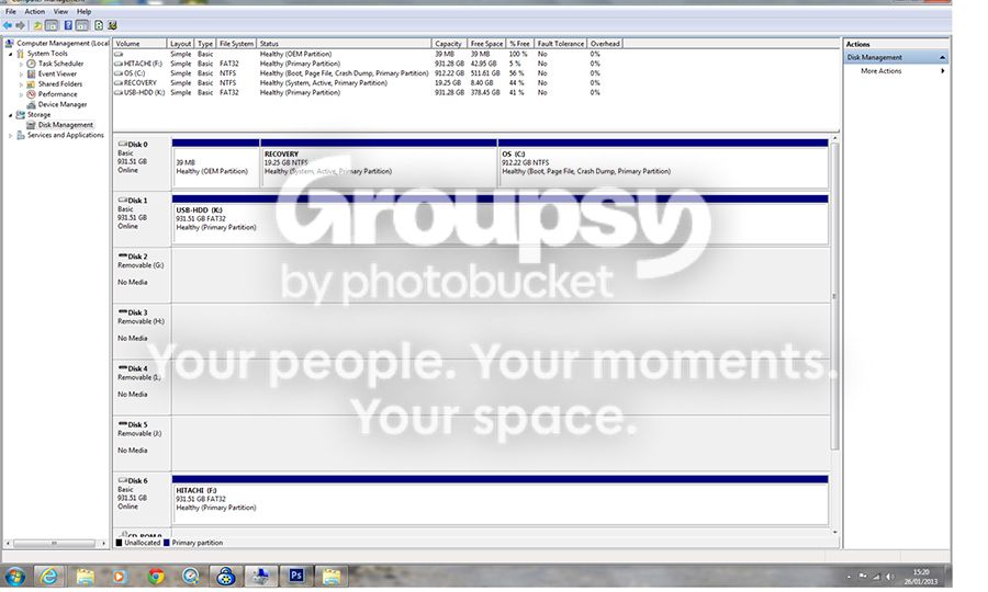

Can you please click Start, right click My Computer, click Manage, then click on Disk Management under Storage and post a print screen of the Disk Management utility so we can see what's going on.
Hi here is a screen print
whats is happening is that I cant access the external drives (disc6 Hitachi and disc1 usbHDD on the screen print) with programs like photoshop or canon zoombrowser
but if I go to computer ( am on windows 7) I can access them
I have tried 2 different external drives and they are fine so I suspect that there is a problem with the external drives disc6 and disc1
