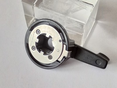

I really see no need to keep the CW Winder. It's in lovely condition though, so hopefully a good sale item. BUT, there is no winder crank with the camera. The OE Winder Crank E (44086) sell for quite unfathomable money. But I've found a guy on ebay who 3D prints alternatives.

There’s a crank on eBay and probably be harder and harder to find
