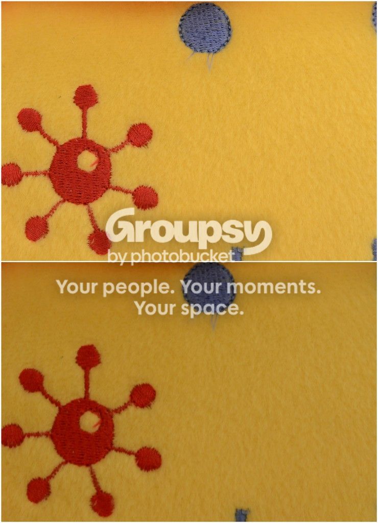

I bought my brand new Nikon D7000 in January this year and almost straight the way felt the images weren't as sharp as from my outgoing Nikon D5100.
So I thought I needed to fine tune my lenses but even after this still felt they weren't as good as they should be. Then I read that images taken through live view are usually sharper which they were by a long long way so I called HDEW (the retailer) who asked me to send the camera to A J Johnstone in Glasgow for a repair. It was returned this week having accepted a fault where it was dismantled and body depths reset and it was recalibrated at a cost to HDEW of £150+.
So I tried some shots in my garden with my 18-105mm, 40mm and 55-200mm lens and felt they weren't as sharp as they should be unless live view is used (never usually use LV). So I needed to carry out more controlled testing but haven't felt like it so last evening shot a few of my grand daughter's soft ride on toy with a sample below - top shot with live view and bottom shot at no fine tuning as any other setting plus or minus was worse.
So should I accept shots through the VF to be far worse than through LV.
Any advice what to do now is appreciated as I am so fed up and not in the best of health to faff around with copious amounts of testing - where's the bloody bin maybe.
KEEP ON CLICKING THROUGH FOR BIGGER
Both 1/4 sec, f7.1 400iso on tripod using remote release.
Shoot the same thing at widest f stop and 100 ISO and repost! I had same trouble with the same body! Mine was back focusing by 20 in fine tune
My d7100 was sharp as a pin shooting through view finder but was out of focus by live view badly! I sold it as I couldn't cure it
The second one seems under exposed and more smudged on bottom of pic, back focussing?. With live view, isn't it usually a larger focussing mode (green square on screen) are you then using spot focussing when using the VF??? so the test maybe inconsistent?
Same position on tripod, same lighting and same focusing choice AF-S for LV and VF??

Wow thanks a lot for your kind help. I've just been in the garden/conservatory taking some more controlled shots. I refuse to print out a test sheet and would rather emulate my real life shots and I can soon tell if they're up to my usual (low :)) standards.
I'm not sure if my camera will allow quiet mode as well as remote release or even quiet mode with delayed shot. I need to take a look at that :)

I'm a complete bloody idiot :banghead::banghead::banghead::banghead::banghead::banghead::banghead::banghead:
It's me not the repaired camera :banghead::banghead::banghead::banghead::banghead::banghead::banghead::banghead:
I was not setting the fine tuning right and now I have fine tuned by a number of methods as suggested on other threads I realise all my lenses are spot on :oops: :$
