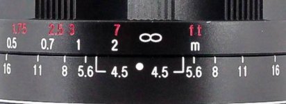

Set infinity against the right hand tick for the aperture in use and the left hand tick will show you the closest distance which will also be adequately sharp. At f4.5 (wide open) your depth of field will run from roughly 2.5 feet to infinity.
The only time you'll need to refocus is if you're working really close and wide open. At f16, you'll be hard pressed to find a reason to shift the focus!
