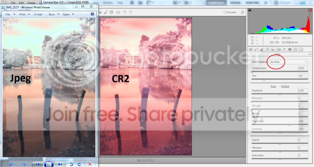

So I am doing some InfraRed shooting which includes funky custom white balances, but that's not my quiery per se. Basically I've got home to edit some pictures - I shoot in RAW+L Jpeg - and the CR2 white balance and Jpeg white balance don't match!
Am I being stupid? The Jpeg white balance is what I want, without the pink tinge. But all options on the white balance setting in Camera RAW 6.0 are incorrect - the "As Shot" option should be correct, no?!
Please see image:
Am I being stupid? What's happened?

Hmm... surely they should just be identical? :-/
And no, I don't think I can get the white balance I want from fiddling with settings, which is what's pee'd me off. It's a very specific and very odd white balance used for Infra Red, and without it the images come out completely wrong when edited in post production :bang:

I've found out via flickr that it's due to the white balance I am using being below 2000k. So the Jpeg is spurted out correctly as a Jpeg is, but the RAW file can't be viewed with ACR when it's temperature is less than 2000k. Makes sense - and is really annoying :bonk:
