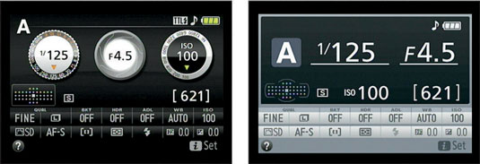

Hi Esther et al
I could explain in simple terms, still long-winded, about the 39 points, but this is really for a single moving object. If you want to try and get 2 kids and a dog all in focus, you're better off learning a bit about aperture ... plus shooting in Auto Area AF.
Let's start with what your Info display looks like ... Graphic (L) hopefully, not Classic (R)
Ignore the numbers/settings in the above image, look at the rectangle with 39 dots just above the word FINE. The central one is highlighted depicting a single focus point, the best way to shoot most of the time. We'll come back to the 39 display. Read on with your camera in A (Aperture Priority), my mode of choice.
See above image again ... below the FINE word, right a bit, it says AF-S, select that on your camera and then select the default AF-A Focus Mode. With these Focus Modes you are selecting HOW you focus. AF-A means Auto, and mine's on Auto all the time (default) works perfectly ... for me anyway but some say it can occasionally get confused between the stationery and the moving.
See above image again ... just to the right of the Focus Mode selector there's [o] kinda thing, select that and change your AF Area Mode. With these AF Area Modes you are selecting WHERE you focus. Ignore the 9, 21, 39 points, that leaves you with Single, 3D, and Auto [see my mention of Auto Area AF in my first paragraph]. Select 3D for chasing a moving object.
Hit the MENU button on your camera, select the pencil, select a Autofocus, a2 Number of focus points .... 39 and 11 are your options. 39 is said to be better for unpredictable movements. Select either ...
See above image again ... the rectangle with the 39 dots, when AF39 is selected they will all be highlighted, when AF11 is selected 11 will be highlighted.
Now sit back, put your feet up, well, one foot anyway. Look thru your viewfinder, half press the shutter button, press the OK button to bring your focus point into the centre if it's not there already. With a half pressed shutter button aim at your foot, pan your camera and/or move your foot and see what happens.
There's more to it, but hopefully that will get a conversation started.
I'd be pleased to hear any comments, additions, criticism. :D

d00d thank you too so much for the detailed reply, I've been out all day at a theme park so only just had the chance to sit down and alter my camera to your recommended settings, I see now that the 1 focus square follows my foot around which I assume is great for things that move, I have several photos of my foot now! Would those settings be appropriate for more than one moving object at a time?
