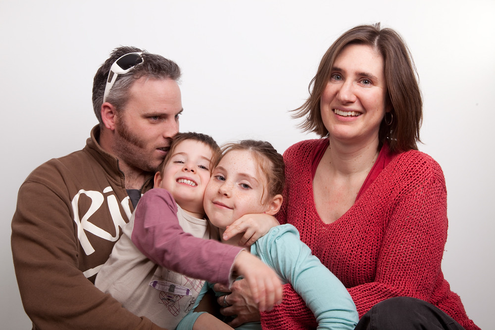

So, having collected a Lastolite Hilite the other day I finally got around to trialling it, all be it too briefly, tonight.
My setup was: 2 x speedlites to light it and a softbox and shoot-through to light the guinea-pigs.
I need a bit of help with the background (as I expected), i.e. the greyness.....any suggestions?
Not looking for critique of the actual image, it's just a good one to show the grey background.
[url=http://www.flickr.com/photos/28984351@N04/5350445286/] Logan_etal by Steve J Lacey, on Flickr[/URL]
To me it looks like you need more power from your lights.
Can you remember what settings you had on the speedlights and your camera? That may help as to pinpoint where you're going wrong (so to speak).
More power would just increase the edge degradation, visible in the hair. You don't need more power, you need more even distribution of the light - never the easiest thing to do when using hotshoe flashes, but definately do-able, just by adjusting the angle.
Looks to me like the subject is pretty close to the background.
If you want white meter the background at least 1 stop more than the subject. Normally the subjects are taken at around f8 mainly for depth that offers and sharpness of most lenses at that aperture. So you need the background lights aroud f11 or maybe a touch more. As Garry says the main thing is to get the light even - pretty tough. Turn the flashes towards the back of the hilite and fire into the white surface - use your flash meter pointed at the background (up close) to measure the light coming from the background - If you get a consistent reading across the hilite then great.
From the image you have, light is falling off top to bottom. THe bottom of the hilite is pretty dark and there is more light on the cameras right than on the left. So angle the flashes appropriately. Once you have it set correctly, make a note of power settings and check the angles so you can repeat.

I can't see any edge degradation. The background is grey, and more grey around the areas where the adults are shading the background from the front lights. I may be wrong, but I supect the HiLight itself is fairly evenly lit behind, just under-exposed.
In terms of exposure, just crank up the flashes in the HiLight - with blinkies enabled, until they flash. You are now on the brink of over exposure and if you're happy with the level of the front lights, take the HiLite power up just a smidge, and it will blow to pure white.
I find the best way to light the HiLite with hot-shoe guns is to aim them about two thirds of the way across (ie just past the middle) but stick a tiny piece of card on the flash head with BluTack so that no light is allowed to fall directly on the front panel.

Wisp of stray hair on the rhs is the most obvious but there's clear smooshiness going on in both the adults' shoulders.
Having said that it looks like a slow shutter speed or that kid's arm is moving really quickly (by no means impossible).
I'd move them forwars - as far away from the hilite as you can. Then you can safely increase the power inside the hilite. Also consider fitting diffuser caps to the flash guns (like stofens) to widen the spread as the light leaves them.

I know what I did wrong. I had the background set to f/5.6 and my family set to f/8
I'm not sure why I did this but that's what developing a new technique is all about I guess!!
I will try again at the weekend and re-post for more crtitique if that's ok with everyone. Thanks for the feedback.
