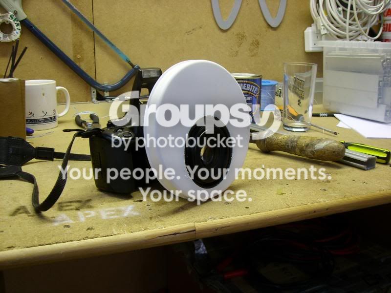

Just thought i would post up an experiment ive done today. Ive made a home made diffuser for a camera with an on board flash. Ive just gone and taken some test shots with it and im pretty pleased with the improvment! Obviously it works on some pictures better than others, how close you are will make a difference ect. Here are the test shots and a shot of it on the camera :)

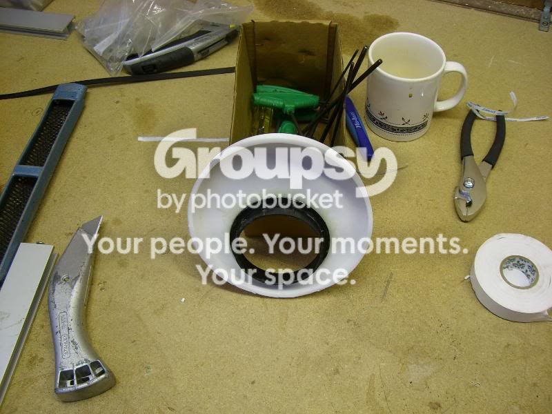

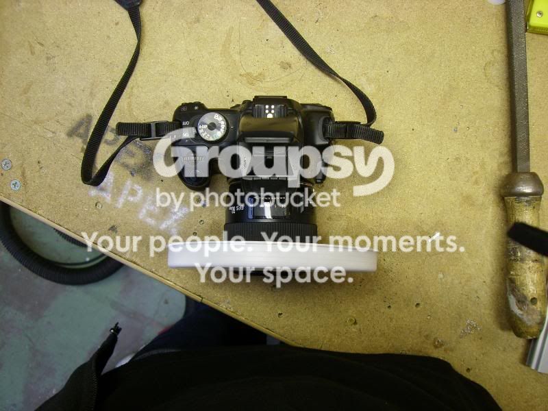

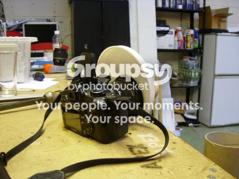

And some pics of what it looks like, on and off the camera

I made this gadget as i was sick of the real harsh flash you get off the on camera flash
Little diffusers like that make some difference if you're really close, as the flash becomes relatively bigger compared to the subject. At distance though, the effect is negligible.
It's making some difference inside your light walled garage as the light is bouncing around all over the place, softening and filling in the shadows by reflection. It also looks like the flash is running out of puff to do this in one or two pics, as it spreads light everywhere and uses a lot of power.
To see what effect the diffuser is having on its own, shoot something outside when it's dark where there is no light being bounced back from walls and ceilling etc, at normal shooting distance. Prepare to be disapointed though - the major difference will be that the flash will have no range at all and the light will be virtually identical both with and without the diffuser :(

Is that actually diffusing the light though? It looks so thick that I doubt any light can get through it, instead it just bounces back and around the room.
i thought this at first but light is getting through
ill try and take a shot with another camera of mine with the diffuser on in mid flash to show you
