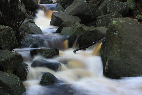

Dunno if this is what you're after - F29 at 2 seconds shutter.
You have to use manual setting for good results, a long shutter speed and large f number (small aperture) is the correct way to do it. I have a 105 micro lens that stops down to f32, this would give a very long shutter speed due to almost pinhole aperture.
eg: small aperture = less light entering and greater depth of field; long shutter opening to compensate less light = silky water.

Hi - i attempted to shoot long exposure and small aperture at a nearby waterfall. most images were blurred and it didnt help having sunlight directly into camera but i was able to shelter under canopies of trees. what do you think of this one, maybe not enough silky water but the background is in focus.

You were really making things difficult for yourself with that lighting. A very high contrast shot where perhaps, you would have been better off targeting a more evenly lit part of the scene.
You mention that most of the shots were blurred. Were you using a tripod? For longer exposures its really essential to use a tripod and preferably a remote release, although the self timer is a good alternative. Mirror lock up is also recommended.
You've succeeded in blurring the water (River Almond shot, right?) much slower and you would probably have burnt out the highlights, leaving a large area of white with no detail.
Try again perhaps earlier or later in the day when the sun is not so high.
Keep practising, its fun and you will get some great results, I'm sure. :)

As HH says, everything was against you but a tripod or a "sit the camera on a brick-pod" is essential.
Keep trying, you'll get it!
Gary
PS, there's no EXIF attached to the image, this would help to help you ;)
i had my tripod but the mud was near up to my ankles so i rested my camera on the old stone wall which wasnt very flat. i take all your points on board and il try to get down there at sunset (wellies on this time!). i knew when i was taking the pictures that the direct sun was going to be a problem. also, sorry for confusing you all with the other thread but i didnt think i was allowed to post images on "equipment forum", after id done it! cheers
