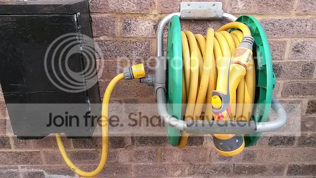

The whole thing here is under 2 years old. It was ok until last year when the connector kept coming off. So I went and bought new connectors.
So far this year it's happening again. The connector comes off a little while after the water is turned on. I have tried turning the outside tap fully on and only a little bit, either way the connector comes off.
Anyone got a fix for this?
Weird though.

I did think that but at the end of the day the connector and the center part doesn't cost much.
The only thing I'm thinking now if I glue it is, if it gives there will it end up giving somewhere else. I don't want to end up gluing and duct taping the whole house lol

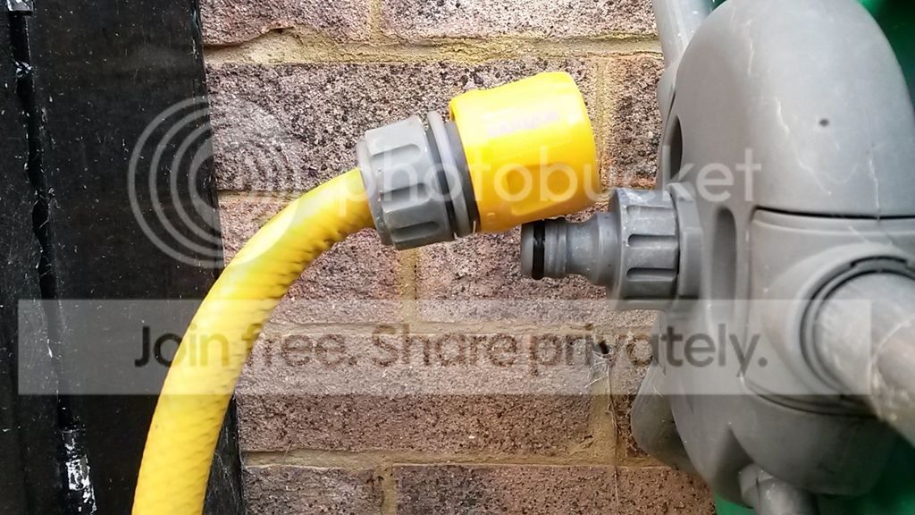

The hose connector on the left does not look to be a genuine Hozelock, so there may be slight size differences in the 2 fittings? - after checking that the internal prongs are releasing correctly and clicking firmly on as there looks to be some wear on the hose reel outlet, you could check you have the correct size O ring or try using a slightly larger diameter O ring.
Looks genuine to me, albeit a few years old. After having a connector fail while we were away last year (HUGE water bill...), I've replaced all the connectors with brass ones sourced through Amazon. I've also rigged up a water butt with a suitable connector so the most I can spill next month is 100 litres!

It is a genuine one, from b&q.
I tried something like that Cobra. I put the hose straight through where the male/female connector are. Straight on the tap it never came off. Only problem that way is once I done it I couldn't wind it back in... DOH!! :banghead:
Lower your hose reel so it is lower than the tap feed
In your case place the steel bracket holding the reel level with the bottom of the black box

Lower the reel or move it a bit more to the right ;) You'll have less tension on the connection and it will make a better connection...Failing that just regurarly replace the connector ;)

Thanks for all the tips. I will try lowering the reel first, then jubilee clip it, then try Draper connectors, and if none of them work I'll glue it. If it still does it I will move all my plants under the tap area lol
replace BOTH connectors male and female with a pair that are from the same makers ,the right hand one should have a simple screw thread .its just different tolerances from different manufacturers thats causing the problem .probably cost about a fiver far simpler solution that actually works
the ONLY other thing i can see that MIGHT be the cause of the problem the left hand connector you say has been replaced ,this is on the IN-FLOW part of the pipe .have you replaced this with a stop valve connector by mistake .there are TWO very different types of hose connector one with a stop valve and one thats a straight through flow
It's all hozelock, every part of it. I also made sure to get the correct connector when I replaced it :)
IIRC correctly the stop-valve one has a distinctive red ring. The one in the photo is a standard connector.
Besides, a stop-flow connector would build pressure on the tapside, so wouldn't explain the disconnection at the hose side of the connector.

I have always had the same trouble, the reason being is that the male side of the connector spins every time the hose is pulled out and wears away the small pins in the female side enough for it to pop off. I have tried all diferrent makes but the same thing happens.
The Spear and Jackson brass connectors from Amazon have metal balls so should last a lot longer. The downside could be that using brass connectors could make the male thread on the reel itself the weak point and that's the most expensive part!

I've had the whole hose out and there no twist, kinks etc. I might give Hozelock a call in the morning and see what they say.
