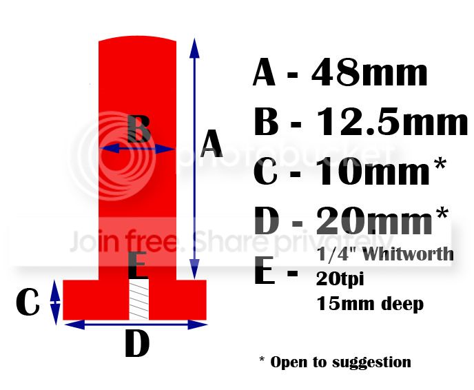

I'm looking for something - I know what it is.. I know what it looks like.. I know the dimensions.. but it's something that doesn't actually exist..
Does anyone here work in any kind of metal 'item' production facility - or could point me in the right direction..
The closest item name that I can find is something called a parallel pin.. but with an internal tripod thread..
It would be a tubular shaped item - 48mm Long, Diameter 12.5mm with a 15mm tripod thread going up inside from the base.
It would look like this:
Does anyone have any ideas as to where I might get one produced?

Thread is 1/4" Whitworth 20tpi for camera tripod fitting

I think 3 is right, just wanted to check the dimensions though. For a shoulder rig it would need to be 15mm diameter (Industry Standard) about 2" long and then the tripod thread that is 1/4"-20. If these aren't the dimensions OP is after just make his. However I think this is the required sizes :thumbs:
¼ unc will fit fine the dimensions are so close to ¼whit it make no difference

The one in the video appears to be brass? I'm looking for something that would take the weight of the steadicam, a 5d2 and a 50mm lens.. I'm sure other materials would also be suitable... Interestingly the one in the video has a lip at the bottom, which I'm guessing makes it steadier on the tripod plate...

I'm going by the sizes quoted in the comments below the video itself... let me check the width and depth of the hole in the bottom of this steadicam unit...
Not sure I'd trust my kit to a thread in aluminium personally. Especially if the thread is used a lot. Not without a helicoil being fitted, anyway. (I don't have 1/4 BSW helicoils).
Brass would be better, stainless steel best IMHO...
Sorry it took me a while to get around to measuring - but I'd say the above measurements are pretty much spot on...
The one in the video I guess was the above dimension - but had an extra wide part at the base which I'm guessing was for added stability when screwed to the plate... So the insert bit was 48mm Long, Diameter 12.5mm. I'd then guess the video one probably had an extra 5-10mm of 'base' that was wider.
From those that offered assistance here - is this something you think possible? :) Or would it be a straight piece we'd be looking at without the extra 'bulge' at the bottom?
Would this be the kind of thing? Open to discussion in terms of the base part - whether it's needed or not?
If I've got that tap that size (need to check) then it's no problem to make you one from ali. If no tap, then I can do all but thread it! If you want to buy me a suitable tap, I can do that bit too. If you want it in a material other than ali (preferably not stainless, it's a b@stard to work with) then I'd need a bit of brass bar (20mm or inch).
You could buy the bar on ebay and have it posted direct to me.
