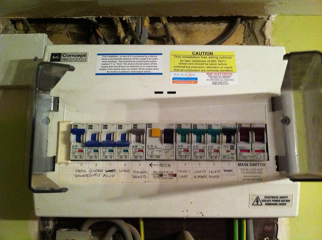

Where is the location of the socket/imac Carl?
Is it fed from the trip marked 'house sockets' or 'kitchen sockets'?
Your consumer unit is 16th edition wiring regulations and not 17th, but the work you have had carried out is covered if it is on either of the circuits mentioned.
It is off the house sockets bit. Mac is a new aluminium backed one. Still nothing off it since I changed sockets, but it didn't for ages in the original plug either.
Seeing the board is it still worth my while checking the plug by undoing it John? or is it just worth putting the mac back in the socket and seeing what happens, then if it happens again send the mac back?

Give it a check Carl. Something like reverse polarity would not trip the RCD.
It is doubtful that it would cause a shock either though, but you might as well check it for peace of mind.
