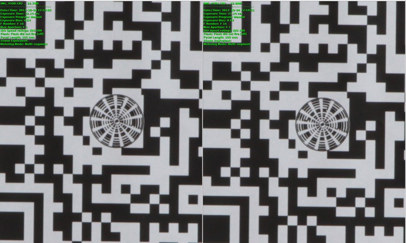

24-105 Tripod-mounted IS on/off
100-400 Tripod mounted IS on/off
