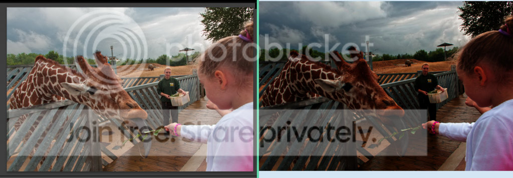

See above screenshot on the left is LR, on the right is the exported file in Windows Photo Viewer.
Below is the exported file uploaded.
I have also downloaded a photo from the net and opened it in photo viewer and it is too dark. Any idea why photo viewer is showing them so dark?
I have Colormunki software running but wouldn't have thought it would make a difference.
