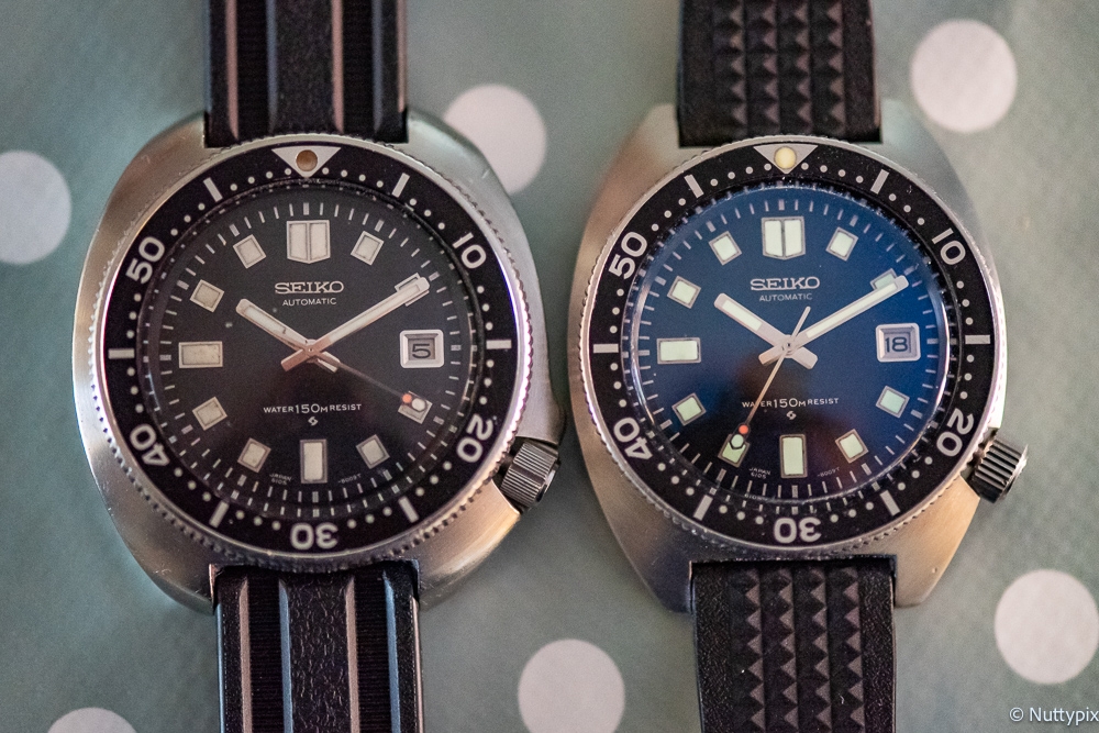

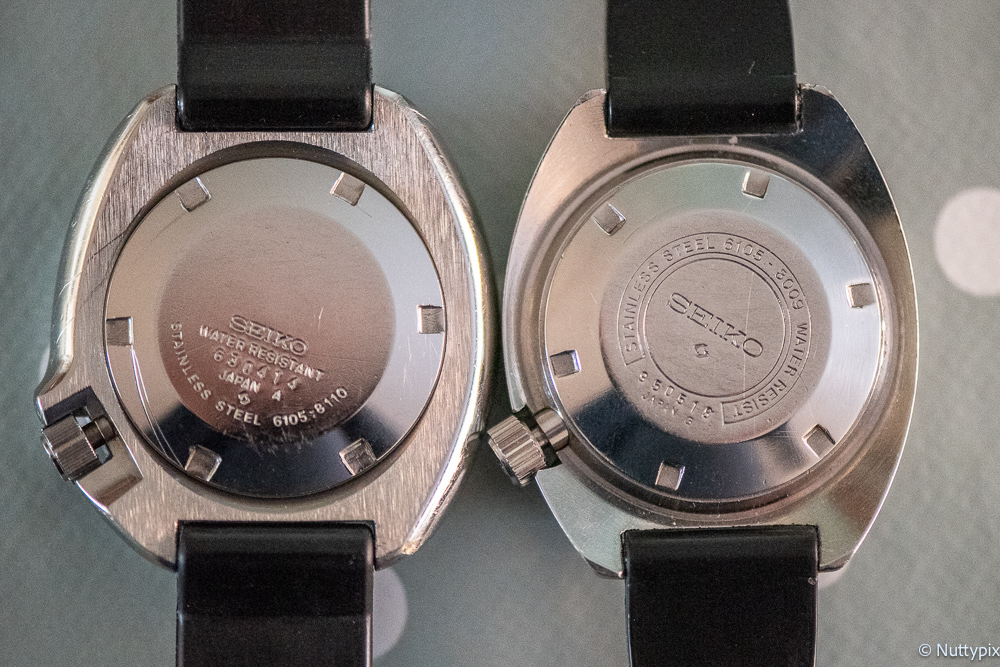

a couple of mine - but originals
6105_8110 and 6105_8009
I have quite a few old Seiko's
