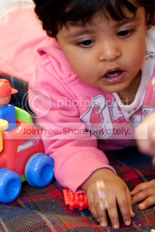

Hi - I'm not really clued up enough to know what front focussing really means but i suspect i am suffering from it.
I checked my camera and the focus point was the mouth - the right side of it. As you can see in the pic the face is soft but the rug just in front of her is pin sharp! Is this what people mean by front focussing?
I'm gutted because I've noticed many of my wide open shots are slightly out of focus and always thought it was my own lack of skill.. However now i think it is an issue with the camera or the lens. I have had them for a year now though so i can't exactly take them back as faulty :(
I read there is a micro focus capability in my camera - the 50d. Would this help or is the lens too 'out'?
Love to hear your thoughts.
Dub
50d body, 17-55mm f/2.8 IS lens at IS800, f/2.8 and 42mm:
9 times out of 10 it's user error. I've plenty of shots like this and I'm sure my lenses are fine. Shoot a static subject while on a tripod (IS off), making sure focus locks and see how it performs. Chances are the child was moving, perhaps you accidentally moved too, maybe you missed your mark with the focus point, maybe the light was low and focus lock didn't actually occur... Plenty of things it could be besides your lens.

At such wide apertures I find that merely the beating of my heart can throw me off. I doubt the equipment is at fault.
From what you guys have written my focus and recompose is probably the guilty party. Am I better off using ai servo mode?
Focus and recompose almost always buggers me up at apertures narrower than f/2.8 so yes, I'd consider re-evaluating your technique.
The canon tutorial on autofocus on B&H photo video (go to site and tutorials and type Canon autofocus in search) helped me no end with this.
I'm afraid that's just user error. Focus is too far out for it to be a calibration issue.
Focus-recompose is tricky at close distance and low f/numbers. You don't say what shutter speed but there is subject movement evident too.
Checking the focus point only tells you which point was used, not necessarily what was focused on when the picture was taken.
Thanks Hoppy. I am pleased to hear that. User error is far easier for me to cure.
