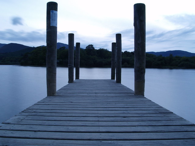

heres the image, when put into live photo gallery or PS and zoomed into there are dots everywhere

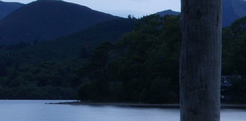

Could you do a crop so we can see the dots?
It sounds like hot pixels to me, chroma noise can also be apparent in long exposures but when you get individual dots of very bright colour, that's hot pixels.

That does seem pretty bad, what was the shutter speed?
it's a 4 year old Olympus E-400
it was a long exposure so no shutter speed,with this pic I had the shutter open 60secs

For a 60sec exposure, that doesn't look much worse than what I'd expect from my 40D without long exposure NR
Yeah, 60 is pretty long, when I said I get some on my 5D I don't really go much over a couple seconds ever, I expect if I did a minute exposure I'd get similar.
