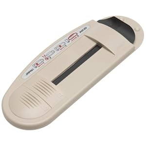

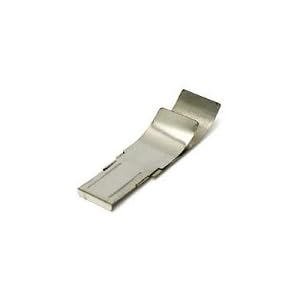

You can get special thin tweezer like gadgets that when put in the gap where the film comes out - it latches onto the film and you can pull it back out.

thanks for your help guys, do you know what the tweezers are called, and where i might be able to get them from? I don't think i'd trust my self with putting a canister back to gether in a changing bag, last time i was in a dark room i even struggled getting the canister apart.

Try going into a proper camera shop and ask very nicely if they have a film retriever, it's a very thin piece of metal with little hooks on it that engage with the sprocket holes, they may even do for you!
It's called a 'Leader-Extractor'...
http://www.amazon.com/Hakuba-Film-Picker-IV/dp/B00004ZCOZ
http://www.amazon.com/Adorama-Film-Leader-Retriever-35mm/dp/B00009R6Q1

If you've a Calumet or Jacobs near you, try one of them. I got one from Calumet that's the same as the second Rob showed. I've seen them in some Jessops within the last year as well.
