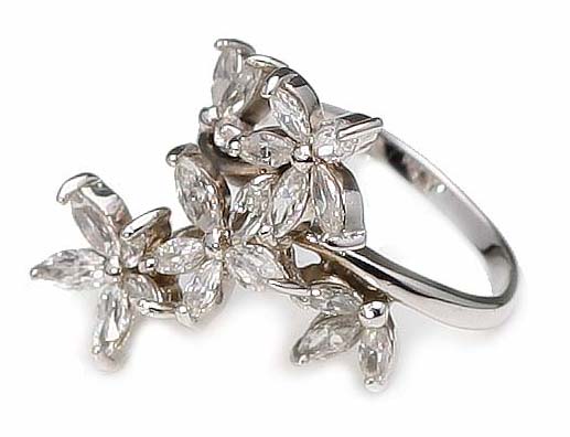

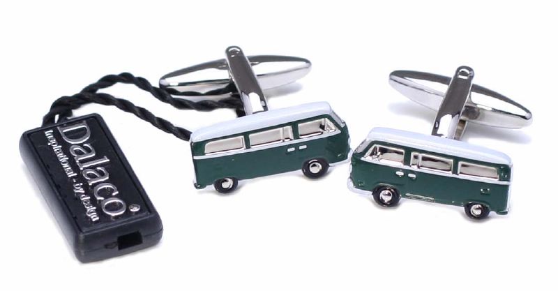

Thanks guys for everything here's the first attempts
C&C welcome and needed
