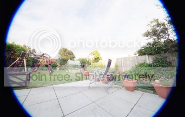

Cracking lens on a crop format sensor (x1.6 on my 400D). Must be awesome on a FF......
Er, sorry, no this is only for 1.3 and 1.6 crop sensor bodies, it will vignette on a full frame.
You're damned right it does:
It's pretty good down to about 14mm. The 12-24mm is better suited to full frame.
