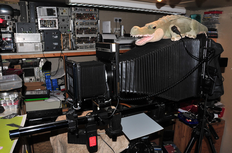

Macro on large format is always a bit of a challange, which camera do you have ? The Sinar system certainly has lots of advantages for macro working the film plane netering set ups allow you to ignore all the complications of bellows and filters factors and just take readings.
yeah its a 90mm super angulon. Ive got a 150 but the focus distance is still around a meter with that so no good at all, the 90 lets me focus on something pretty close so thats all i got. Im not too bothered what it will look like, im just curious :)
